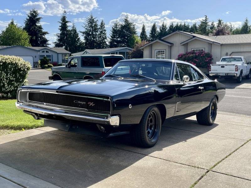

The steering in my 68 Charger is stock and will come out when my new motor is ready but yesterday my steering got looser while tooling around town. I am sure New UCAs and LCAs as well as new coilovers, Borg Warner PS conversion unit and QA1 suspension bits will tighten everything up when the new motor is in. But, right now I have damn near 360º of play in my steering wheel with no change to wheels. BTW this is a non-ps car. What full inspection do you recommend?
Finding someone competent and versed on suspensions and have them evaluate the steering and suspension for what is wrong.
If you've got 360° of play then you're wheel is no longer connected...
Nice car BTW
Clearly the car is totally unsafe and dangerous. I'll save you all the trouble, just send me the car (or let me know where to pick it up) and sign it over to me and you'll be good to go. :)
