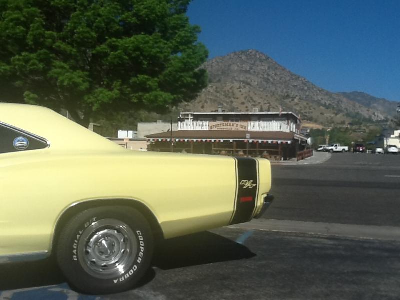

iPadApril2014 1174.jpg69 Coronet R/T. 295 50 15's. Rear. 8" rims. No offset. Minor rub inboard leafs at Willow Springs track with moves never made on the street. Good luck.
