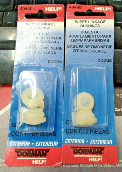

dorman 49440
white nylon snap in bearing/clip

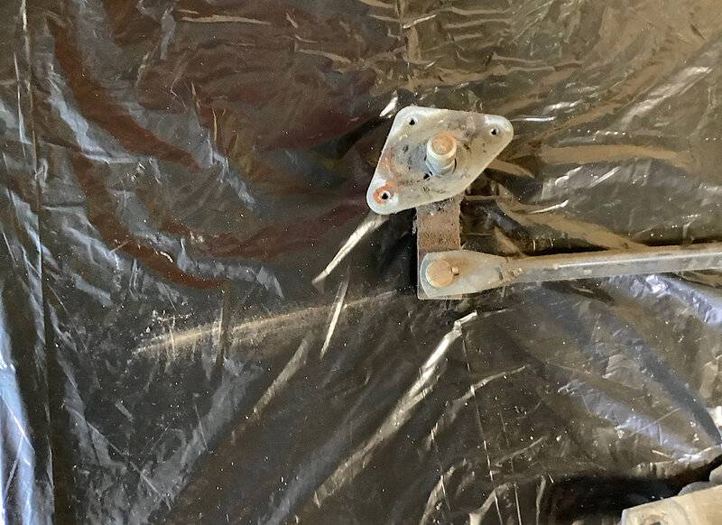

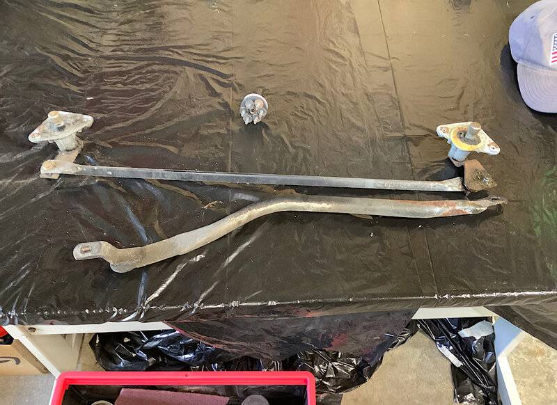

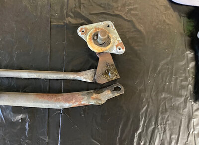

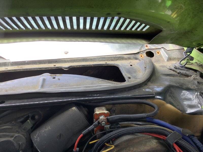

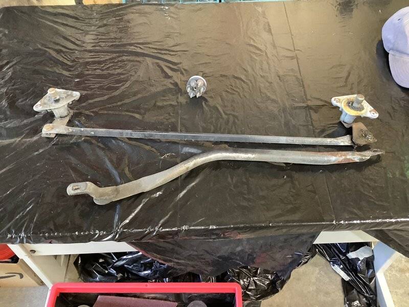

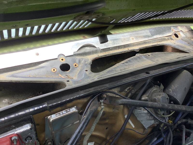

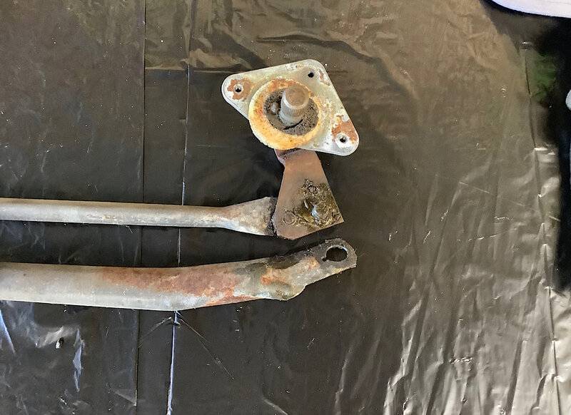

I have replaced those plastic bushings on my Charger and regardless of the name on the package it is still plastic. Last year I did mine and also had a new windshield installed. When I put the bushings in I used generous amounts of red grease on all the bushings and gently pressed the bushings together using a padded vise and everything went together nicely.
Now the wipers park properly under the hood and operate smoothly. Also replaced all the washer tubing as well. Bushings were sourced from the local parts store as well as on Amazon and they will work fine until they don’t and I will do it again when they break. I have replacements in my toolbox drawer.

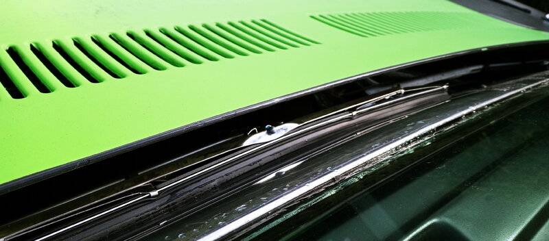

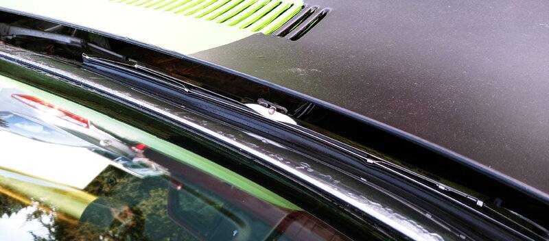

I used the Dorman from local Advance.
Been in since 2012 and in a few rain showers (as happens in FL in the summer nearly every stinkin' day).
