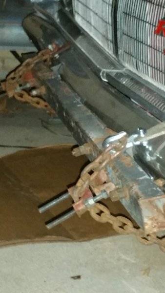

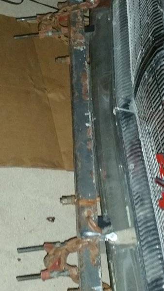

I'm glad I made this tow bar for just this type of situation and to get me home safely. 2 other cars had to be left there at the track because of broken axles. A subaru and a newer camaro.

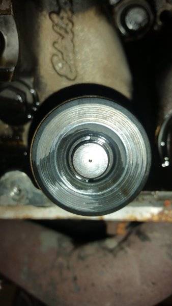

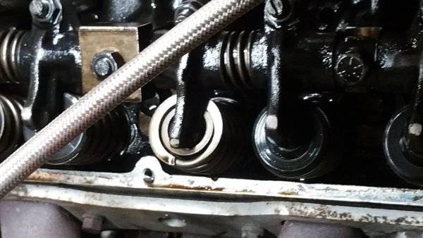

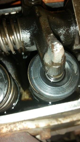

I got lucky so to speak, the piston looks intact with just a small ding above the valve pocket. Found 2 other retainers about to fail.

I could not make out the damage to the retainer in the foto. Is it a hairline crack? Did a valve kiss the piston somehow? Thank you.
In post #4 I show the head with a retainer missing, the other pics show cracks on other retainers. I found 3 cracked half way through and one in half causing the valve to hit the piston and bend. No major damage jut knocked the carbon off. I put a set of 906s on I originally built for the engine at the time.
