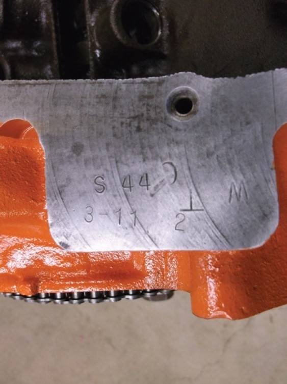

Hello, Has anyone seen a 440 pad to have an S stamped in front of the 440? I know that the letters represent the dates....D is for 1968, F is for 1970, so on so forth. This 440 clearly has an S right in front of the 440 . Any info would be great.

I was just looking at a pad this evening that had a S on the pad before the 440 it also had a Maltese style cross on the pad, which I had never saw before. This engine was painted blue and was most likely and RV engine, I may be looking at these engines again Saturday, to get a closer look at them, maybe we can discus it further, I only glanced at them, all were either Industrial or RV engines
From what I know the S means a service or special engine (warranty engine )
The Maltese cross means crankshaft is .001" undersized
An "S" could mean either Special Engine, or year designation 1962.
Casting numbers on the block will help determine the correct way to read this.

Now you know there was no 440 in 1962 !!:D
As stated above the s is for special engine and Maltese cross means undersized crank, I have one of these blocks sitting in my garage
S = warranty or over-the-counter replacement block
It should also have a "WT" or "TW" then as well. May or may not have a VIN stamped. May or may not have a rivet hole/tag near the drivers "freeze" plug.
