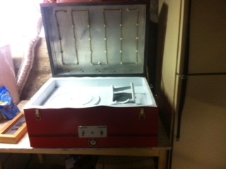

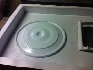

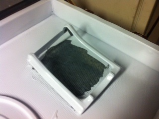

I recently picked up a vacuum thermoformer cheap on Craigslist. I didn't really have a plan for how I would use it, but it just seemed too much fun to pass up and I figured I would find reasons to use it on my Belvedere projects. Has anyone used one of these before? What did you form with it? This unit is 24x32, here is a couple pics from the first time playing with it. I just grabbed an air cleaner cover and a tail light bezel to see how it would work...
