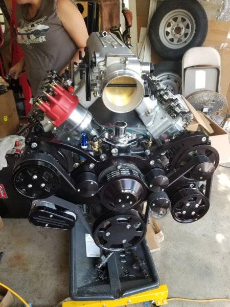

After spending a bazillion dollars on my 440 bullet, I hate to put boring black rubber radiator hoses on it. I bought a red silicone set off Ebay, but they are like 1" or 1 1/4" diameter. way too small. I believe my upper is 1 1/2" on both ends. Lower is 1 3/4" on the radiator and I think 1 1/2" on the pump housing. The radiator is right side upper and left side lower 26"
Any recommendations on what is out there? I have used the flexible stainless before, but was hoping for something else. Color versions of stock would be OK, but no one seems to know the ID's of the hoses, and I already have ones that don't fit.

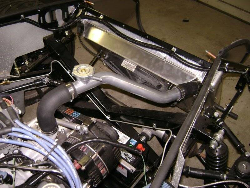

Second think about rigid Stainless tubing with short rubber coupler hoses at either end....
Not a great job but here's a example
