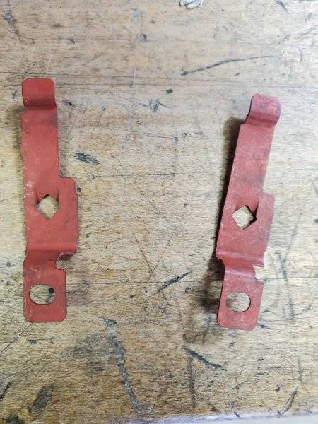

Helping a friend on a 70 Challenger. These two clips was in a bag with all the others. Anyone know what this is?
They go below the windshield to hold it up during assembly... Most folks replace them with rubber wedges..
The rear glass is going in on Monday. These just threw us off on where it went. Are you talking about rear or front? Thanks 1 Wild R/T and Marpar
My cars don't have a normal rear window... The front used those... My glass guy didn't like them, metal on the edge of glass can break the glass, he used rubber wedges and I've seen other guys do the same...
