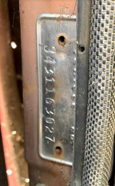

So there’s no tag on the drivers side door post?
Yes the VIN tag is on the A pillar lower. The build tag is missing from the inner fender.
3431163027
This vehicle is a 1963 Plymouth Fury Sport 8 Cylinder
and was the 63,027th car scheduled for production at the
Lynch Road, Detroit, MI assembly plant.
