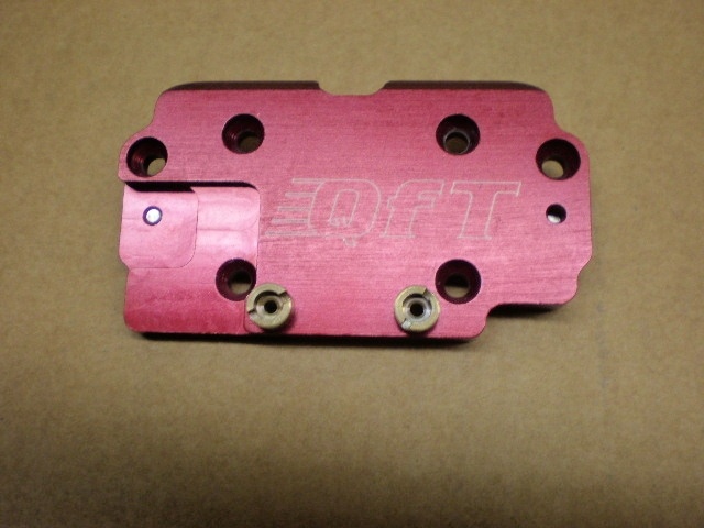

What is the stock idle feed restriction size for 4382 & 4383 '70 outboard carburetors? I'm rebuilding the carbs right now & putting in Quick Fuel metering plates. The paperwork says the screw in idle feed restrictions that the plates come with are .039", but that I can change them. I'd like to go with the stock size hole.
Also, it sure looks like the Quick Fuel plates don't use the separator plate between the main body of the carb & the metering body. Is that right? Just leave out those separator plates?

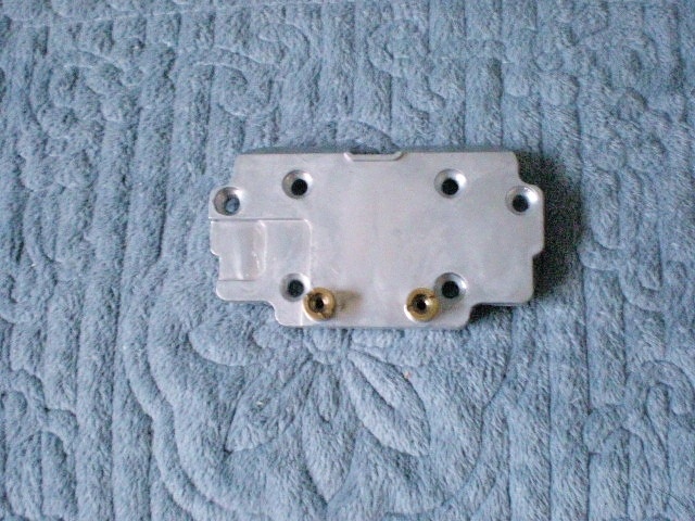

Did you get the cast or billet plate ? The cast plate is the same configuration as the O.E.M. and uses the plate.the billet does not as it is thicker and would interfere with the float.Cast plate top,billet on bottom.

Hmmm.... well, I have the bottom billet plates. I've heard both ways "clears" & "won't clear" the floats. I will make sure to check the clearance carefully. I guess I need to see if Quick Fuel has some .037" idle feed restrictors.

I test-fitted my thick, red Quick Fuel plates with a plate to main body gasket, jets & floats installed to check for any clearance problems. I looked very carefully & the floats (stock black plastic type used in outboard carbs) clears everything just fine. I am not using the separator plate & extra gasket like the stock metering plates use. I "think" the thick Quick Fuel plates don't use those (just metering plate & large blue main body gasket). Is that correct? I haven't seen anything "for sure" about leaving the separator plate & separator plate/metering plate gaskets out when using the Quick Flow metering plates.
Separator plate and extra gasket only with cast metering plate,billet uses only main body gasket.
I have the Billet plates in my outboards and they clear just fine. No plate on mine.

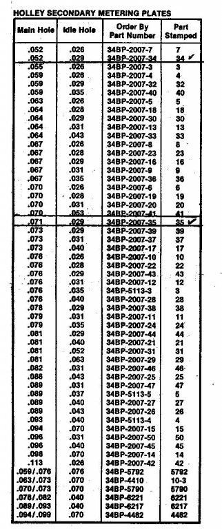

Stock plates are .029 on big block,.043 on TA/AAR.Q/F plates are .037
Thank again 62Max! I just ordered 4 .029" idle feed restrictors from Quick Fuel for $5. I had to call them since it's not listed on their website. I'm just waiting for my #77 jets to arrive for one side of the back carb. This will put all my orifices back to stock specifications & hopefully I can tune out this super-rich condition from there. From some stuff I read online, leaving those larger idle feed restrictions in the Quick Fuel plate would have left me still very, very rich at idle. I think those plates are designed for 3310 4-barrels.
