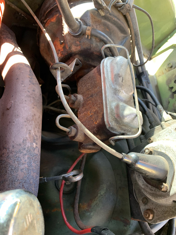

Here are a couple pictures of the brake booster etc.:
So i did a little research and it looks like there is no repro brake booster that is 100% identical. Additional most master cylinders seem to have the connections on the wrong side.
Mine are on the engine side which seems correct given these 2 cars comparable cars:
Also both the mecum car and my car have a support bracket for the line/cable from the cruise control attached to the brake booster.
Furthermore it seems like buying an NOS brake booster would be a bad idea because it most likely will have a vaccum leak aswell due to degradation.
What i found browsing the forum is that getting my original brake booster and master cylinder rebuilt would probably be my best option UNLESS i can find already rebuilt ones.

How do you know that the master cylinder and booster on there is original?
Drum or disc brakes master on it now? Photos? What is the 7th digit of the VIN?
Brake booster will get worse. You can try just intake gasket first and see.

Need to verify if it's the booster leaking.. or the cruise control unit.
Agreed.

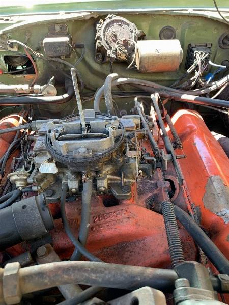

It looks like it has a 1968 carburetor.
