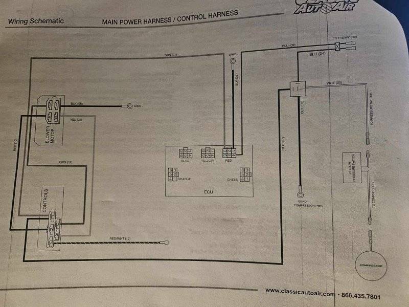

So it cycles. Power is intermittent at the clutch. You will want to wire it before the cycling switch. Classic air has two versions and each is wired different. Does your system have cables off the controls or wires with servo motors. Each will have its own way to wire.
It has wires and servo's. What do you mean before the cycling switch? Is that on the compressor itself, it only has one wire going to it.
No its not on the compressor. Look at your wiring diagram. There also is two versions of the servo control models. So the way you would wire it could be different between the two.-

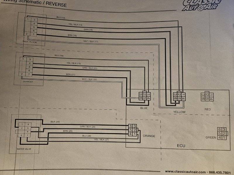

There were only two wiring diagrams, none had a cycling switch, see below. Not sure which one I have but I bought it about three years ago.
