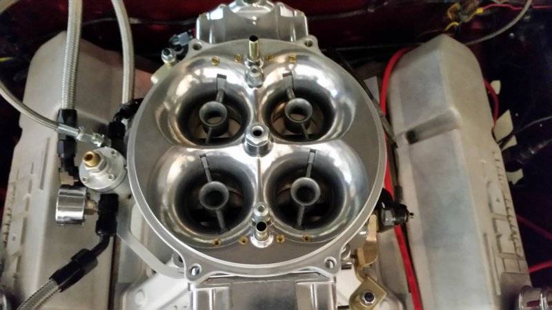

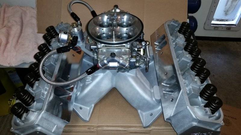

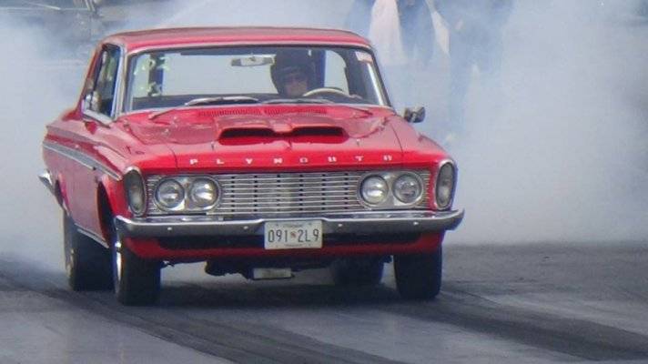

I will go out on a limb here but this is from my DIRECT experience on my 3800lb 66 Coronet with my 12.2-1CR flat tappet Comp Cam motor.
I installed an INDY Single plane intake and #80688 1050 Dominator and went from 10.90 to 10.60 the very next day...with same conditions.
Then later on I had my Standard Port INDY SEZ heads enlarged to MAX WEDGE SIZE and at the same time had them ported to flow around 340cfm.
That improvement took me from 10.60 to 10.30 with nothing else done...
I have other things after these 2 things to improve my ET's down to 10.16 range...2" Dougs Headers with 3.5" collectors, Trans-Brake Tranny and new Hoosier Slicks...but the 6/10's of a second came from the carb/intake setup and the improvement to the Heads.
So...In my opinion if you are still running a 4150 carb (any cfm) and a dual plane intake and standard port and unported cylinder heads you can go much faster with those two items....
I make a disclaimer....I think it takes a 500" motor to take advantage of these things.

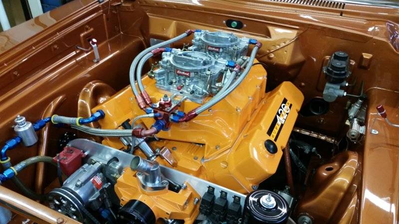

I think you should get rid of those things. They look really small and outdated. :lol:
I see you have upgraded to the see through distributor cap, wires and hoses. With all the weight savings it should make it go faster. :rofl:

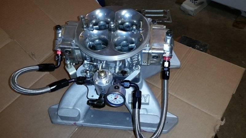

Only pic I had handy

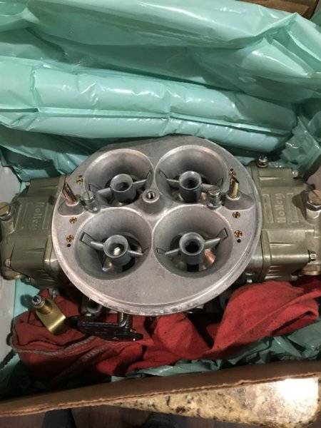

I gotta agree that 1050 dominators and 500 cube motors go together like peanut butter and jelly. The few I’ve tested on my roadrunner scream, even on the old TM6. I plan on running one next year and will get some track data.

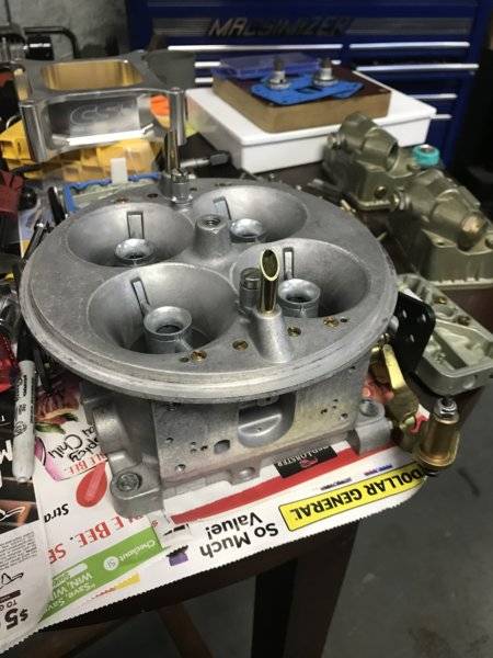

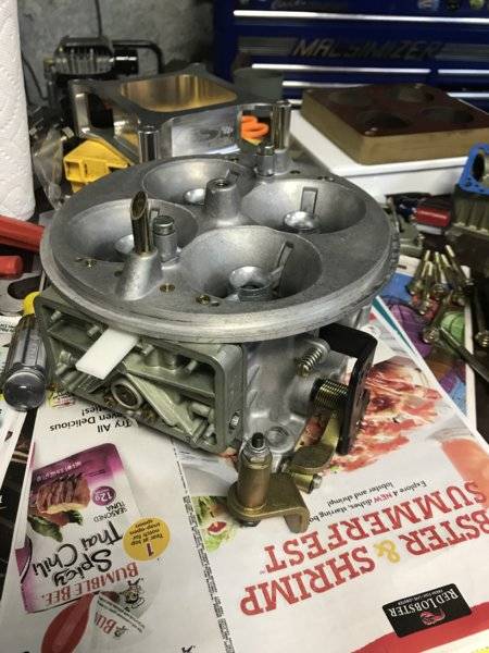

Just picked up this newer 8082. Don’t think the guy liked the way it ran. Looking at the calibration I can see why. It’ll need to go under the knife for some changes before it finds a home on the roadrunner.
