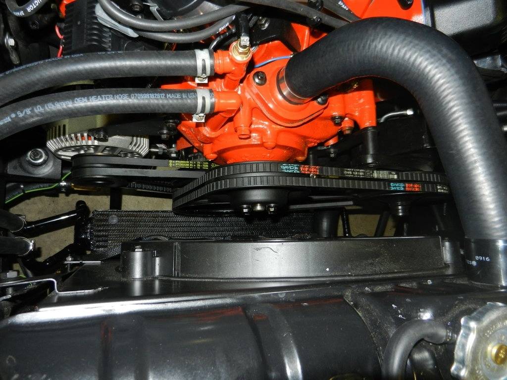

You would be better off to invest $60 and buy a Ford 3G alternator and hang one of those on. You can get a very good one (used) online or at your auto dismantlers. They are clockable ( at the mounting ears)but if you get one with the ears at 180 degrees your good to go. The reason I don't like " 1 wire" is that they don't have a sensing wire which opens/closes the diode circuits to make the alternator put out exactly what you need at any given time. 3g's come in a couple of outputs - I like and use the 130 amp. The regulators come in a single wire configuration ( from any rebuild shop) as well, and, cost about $18 at the dealers and can be changed out in minutes. Pick your pulley - they come in every type imaginable. Mine is hung low and utilizes double-v's but will accept serpentine. Oh, did I mention how quick they respond to load? Won't get that in a single wire.
