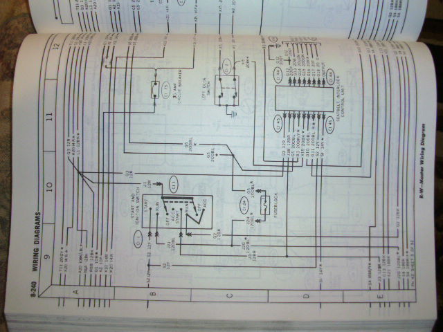

Southernman
switch
see ignition switch

mines one click back for just the radio
Not sure when they quit doing it like this but with the older cars when in the ACC position, you could also turn on everything including the wipers and blower motor...just not the ignition system. That stopped with the newer cars and pretty much only the radio will play but I don't know when that was phased in.
