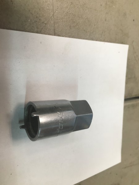

I bought mine from a place on Ebay called Custom machine components, located in Pawleys Island, SC.
He makes al his own products, as far as I know. Good stuff. Note, 69 is on its own, one year only.

For $17 I will gladly wait for the tool. But then again I already have most of them. :D

Snappy makes them for just about everything. Think this is for a GM antenna bezel. The Fn your getting aint worth the Fn your getting.
