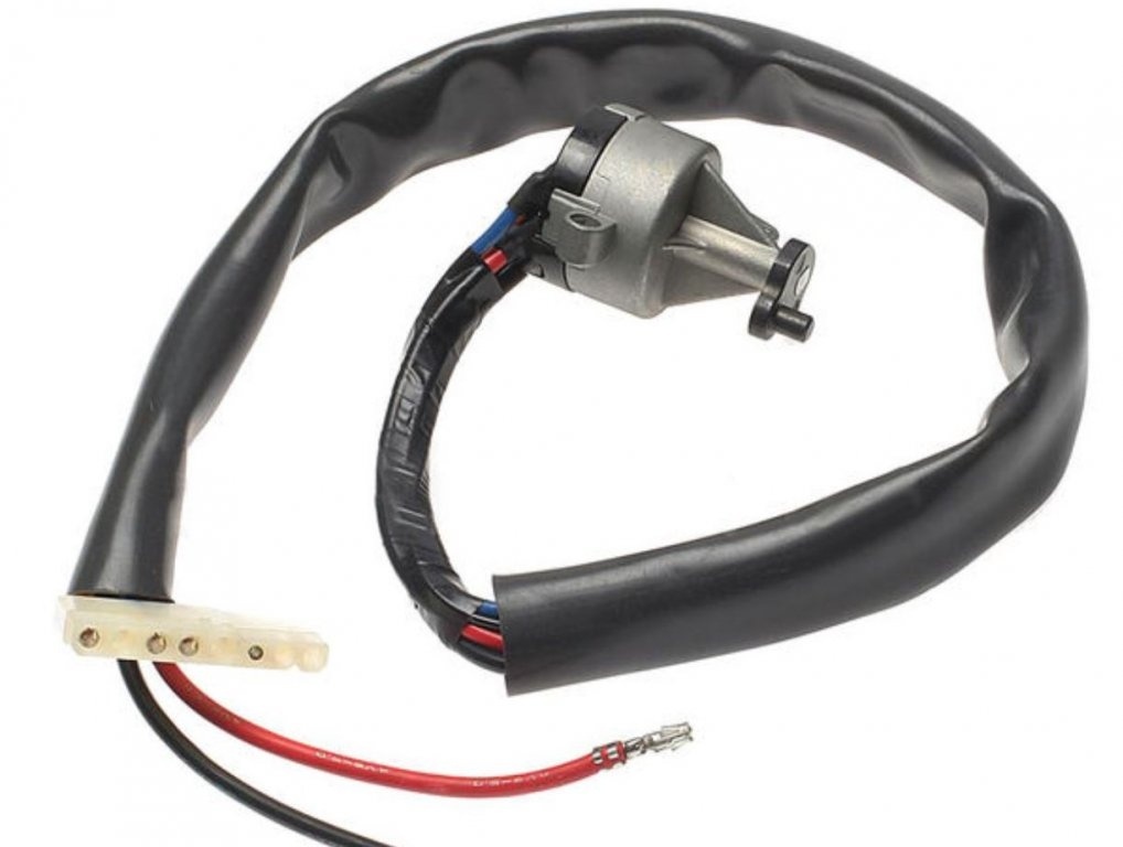

Thanks for that information Yatzee but when I replaced the switch there were no terminals on the switch., Are we talking about the steering column? This is on a 73 R R. I replaced 1 switch in the column.

The switch you replaced, looked like this, right? If all the wires are correct from the plug that this one fits into, then the spark should be cut off when the key is off.
