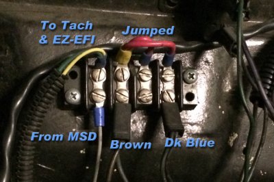

I have the FAST EZ-EFI on my Belvedere, and also an MSD Distributor with the 6AL box. When installing the MSD, I removed the ballast and put a junction block in it's place; I use that block for my Tach trigger and IGN connections.
The FAST Tach trigger is at that block, as well as my Tach signal. The brown and dk. blue wires that connected to the ballast are jumped together now. I've heard people say that there could be starter issues, but I've never had a problem.
The EZ-EFI IGN wire is going to a wire in the dash that was on IGN1 circuit, but since IGN1 and IGN2 are connected at the junction, they both see the same signal during crank and run.
My electrical has been through a lot of transitions, and is now being completely rewired. But initially I started with a Mopar Performance Dist, and carburetors, so when I went to MSD I removed the ballast and put this block in it's place. I used that center red jumper for the electric choke, but going to FAST it was no longer needed.
Since I've had the brown and dk. blue wires jumped like this, I've never had any issues at all, no diodes or relays whatsoever are in the wiring.
