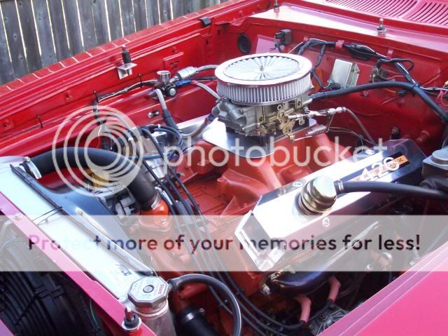

I custom cut mine on both my cars with TTi headers. Used Accell 8000 ceramic. 4 - 90*, 2 - straight, and 2 - 45* worked out the best for me.

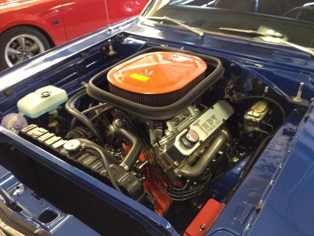

I just ordered a set of wires for a bigblock wedge with TTI headers and he sent me these already made to proper size. And they fit perfect. Ron

Firecores Ron?
