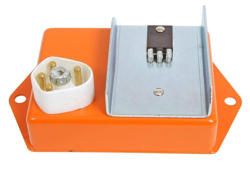

Anyways , remember when Summit Racing was selling an Ignition Module with the TO-220 Transistor mounted on the outside
They have since replaced it with a dummy cover
Summit Racing SUM-851021 Summit Racing™ Ignition Controllers for Mopar | Summit Racing

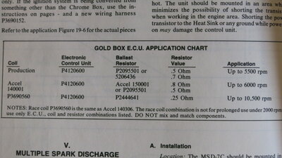

Yes I still have coils 28KV, 45KV and 55KV 1.5 ohn nors. Look at the charts again all the ecru's are not the same even the two orang boxes if Mopar have different max RPM/sInfo overload
