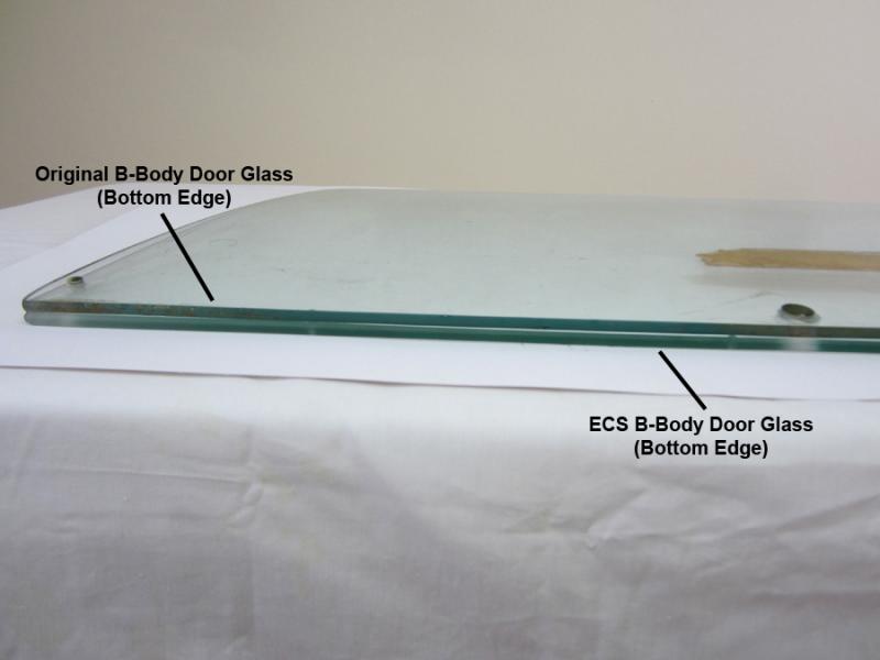

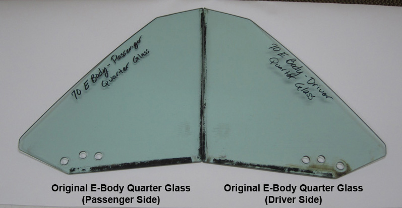

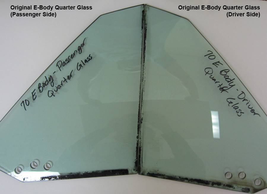

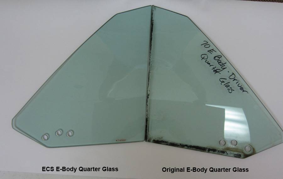

Here is an another example of the incorrect statements made about our glass. A gentleman named Ernie Blumenthal has also commented in the "other Forum" that our E Body glass doesn't fit properly. All I can do is show people a comparison of the original and what we offer. Hundreds of other Customers praise the glass products we provide. They get the same items that this VERY small minority continue to complain about. We match them with the originals and they are exactly the same.

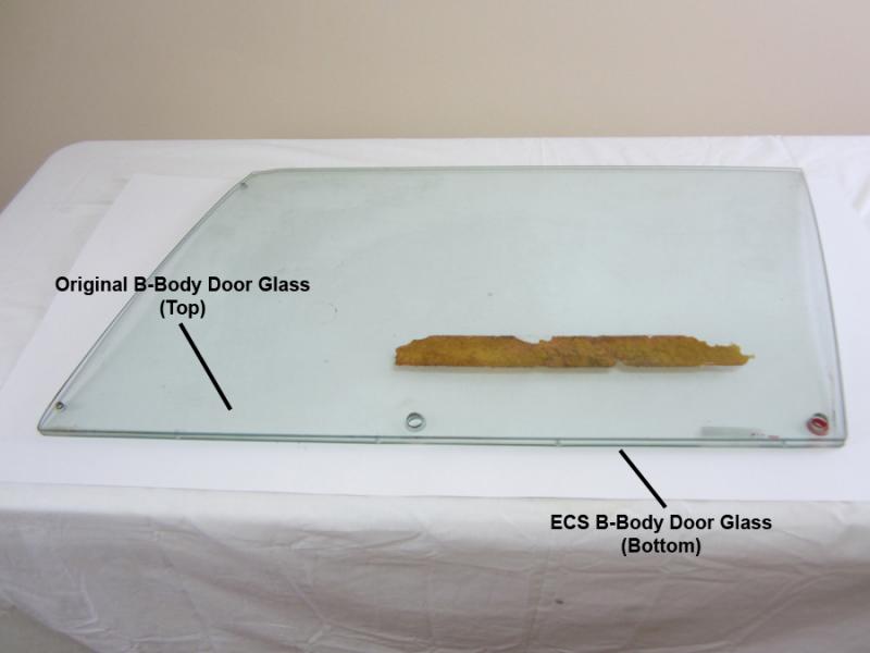

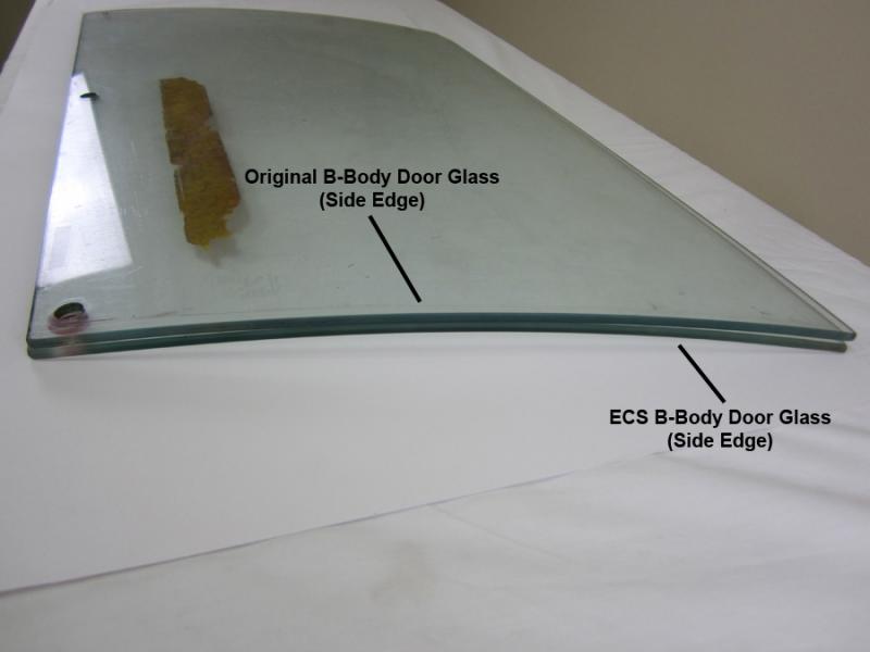

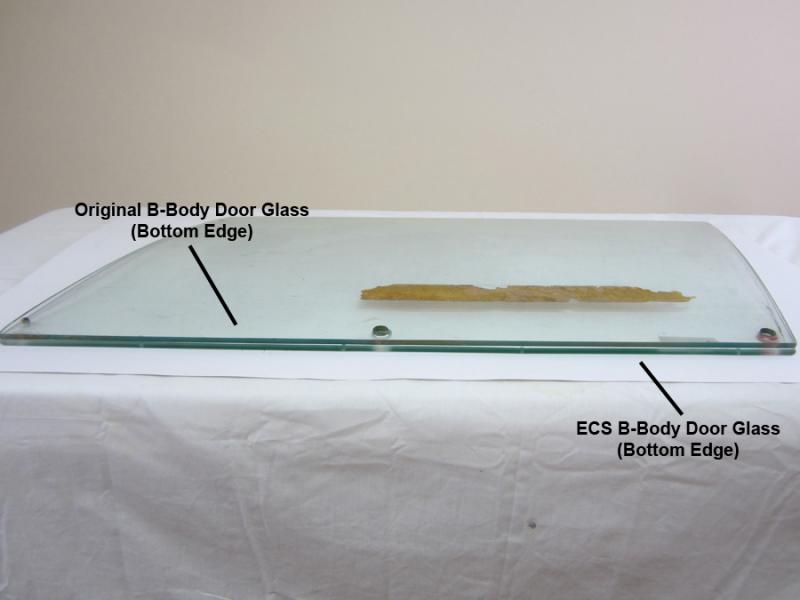

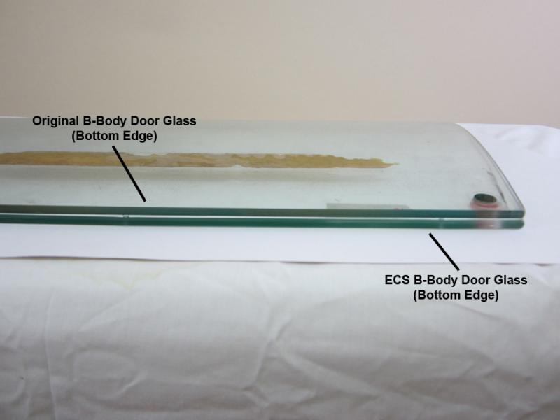

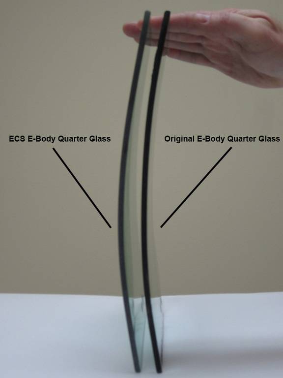

Once again, here are comparisons of what we offer for B Body side glass. No smoke & mirrors, just the facts. Can anyone else see the "badly out of spec" and "bowed" characteristics that were described by Mr. Kaup? Notice how straight the "horizontal plane" is between our reproduction glass and the original example.
