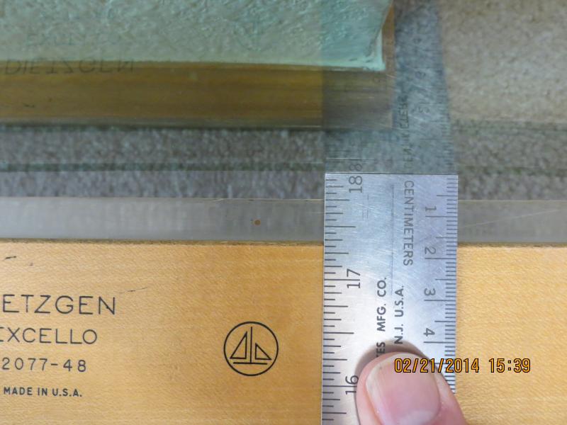

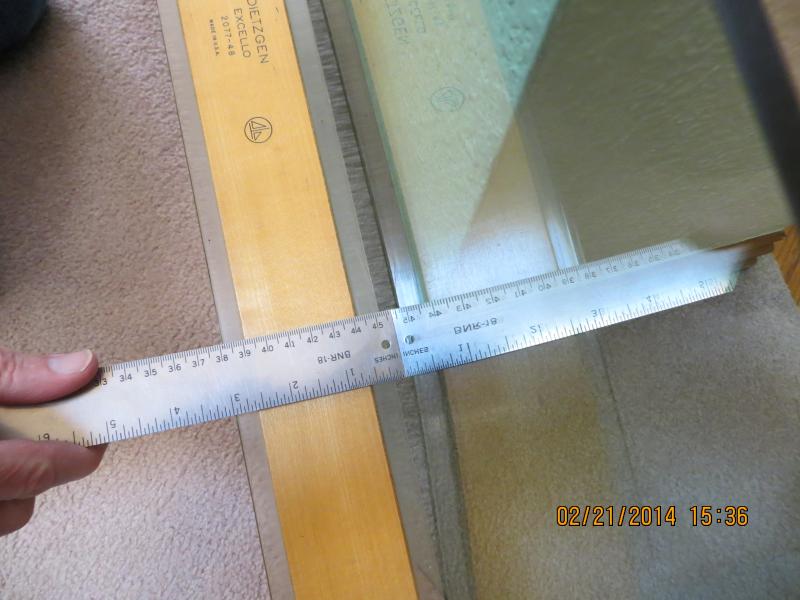

First, I want to report that I got my 69 GTX back today from having its door glass replaced a second time (both times by professionals) with ECS supplied panes. The new replacements fit fine and I am satisfied with them.
With the old glass out I was able to verify the measurements that I first provided ECS on August 21, 2013 (the day after I started this thread) and take photos to support them. The passenger side window as measured from the inside is bowed out near the middle-rear 0.5 cm (slightly over 3/16”). Given the thickness of the glass is about 0.6 cm, it was like trying to roll up and down two glass thicknesses in the channel. The driver side glass is bowed about half as much (0.3 cm). Both measurements are on the horizontal plane which is supposed to be straight. I am a retired mechanical engineer but still know how to take measurements. Two photos of the passenger glass are shown.
What started as a fairly pleasant exchange of private emails with ECS has unfortunately devolved into something less. Along with another customer I have been accused by ECS of “half-truths and lies”. But since ECS has apologized for misrepresenting when I reordered and received replacement glass, I’ll apologize for forgetting that I made the same posting on moparts.com (one day later) as I did on B-Bodies. The “secondary” posting I was referring to was also on moparts.com where a thread entitled “mopar logo windshields” was started by another party on Feb 13. I was the ninth poster and contributed my experiences only after ECS’s name was brought up and another poster recounted his problems with their glass. Anyone who wants to read the entire thread should have no problem finding it.
While I don’t like the idea of being out $549 ($349 for the glass and $200 labor to install – first estimate was $700!) to replace my car’s door glass a second time, I acknowledge (as I have from the beginning) my failure to discover and inform ECS of the problem on a timely basis. On the other hand, ECS should not have shipped defective (yes, defective) glass in the first place. Since ECS complained about not having the old glass back to confirm my complaint, I’m willing to sell it back to them for a reasonable amount. Otherwise, I guess they will just have to keep denying my measurements and (now) photos.

So you have the old set AND the new replacement set? How did the new replacement set compare to the old "defective" set? Shame you couldn't have done pictures like ECS did with laying them over the top of each other to show the deficiencies. Do you have any other pictures of the straight edge up against the glass?
Also, how long did it take the professional glass guy to install the new glass? Did he say he had any issues with it?

I'm not sure what I'm looking at, I can't tell where the bow is in those photos. Did they get stacked up against the new glass for comparison?
