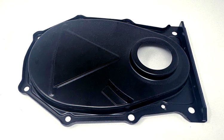

Did you make a choice on the timing cover? I read most of the thread but never saw you mention my billet cover. The billet cover costs a bunch, but it solves a lot of those issues.
BB Timing Chain Cover | AR Engineering
Thank you.
I can't justify $470 for a timing cover and cam button. The features of the precise cam timing adjustability by way of the removeable cover are probably really good for people that need it. I don't think that I would use the special features to make the cost worth it to me.
Did you make a choice on the timing cover? I read most of the thread but never saw you mention my billet cover. The billet cover costs a bunch, but it solves a lot of those issues. I include a plate that allows you to measure the backlash. The timing cover gasket makes a big difference so you have to be careful about which gasket you use.
That is a nice piece.
That does look nice and yes, I have looked at aftermarket covers. If one came without a timing tab I'd have to establish TDC and then weld a tab in place.
The cover from Andy has more features than I'd need.
