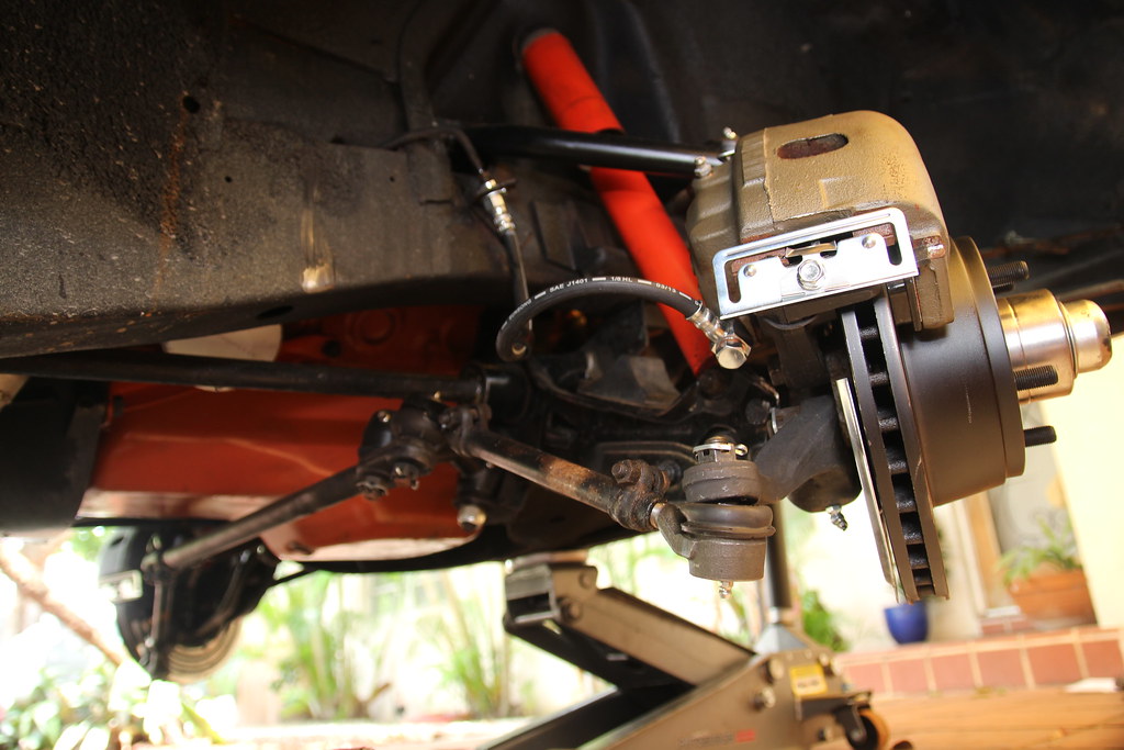

Possibly, don't think so. Caliper misalignment is possible; might be hanging on the anti-rattle rubber bands. Had to pry the dust shield in one spot (see below) when I installed all the new equipment.

Brand new and checked for binding. (P.S.: I do note the dust shield's position - this was the only place it rubbed and was taken care of after the pic).
-Kurt
I also see a wear mark at the base of the hub. When you have the front off the ground are you spinning the hub to hear possible metal to metal?

Looks like the upper part of the dust shield is pushed over against the rotor
Ding, ding, ding. You also have ESP:
Looks like I'm Idiot of the Week. (Good thing it's the end of the week). Rotor is nicely chewed up on the other side. I will say - if nothing else - it's really easy to install the pads reversed on these calipers, if you're rushed and not paying attention...
