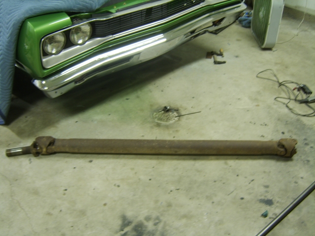

Would a imperial driveshaft double cardan late 60's work in my 69 superbee, I know it will have to be cut and put in new joints. Seems like a alot of places to fail, horsepower, ect?
Is this more of a 4x4 driveshaft thanks?
That's interesting. Resorting to a double CV joint means that shaft in its original application goes through some large angular motions. I'd just use the regular type that came in the B bodies.
That shaft was in the imperial for ride smoothness. . . . not angular issues..
Why would you want that HEAVY hp absorbing shaft in your Superbee ? ? ? ?
You should WANT and GET a AL shaft for your Superbee, not anything heavy robbing power...
That won't bolt into your rear end yoke anyway, they use a different end yoke to bolt to the centering flange of the shaft.
I even convert the imperials to a AL shaft over that old theory smooth ride nonsense
