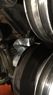

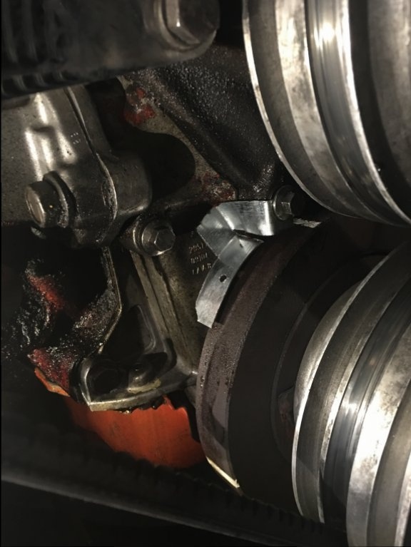

So i have a 360ci motor with a timing chain cover that has the timing marks embossed on the driver side of the casting. I have a cast iron water pump with the outlet side on the driver side as well, very conveniently covering up any view of my damper and timing marks. I honestly don't think my timing has ever been correct since the motor has been put together because of this very problem. I have therefore decided to tackle this issue myself and have fabricated a little metal marker for the opposite side of the pump where there is no obstruction to viewing. I mimicked a similar one I saw pics of online. Here is my solution. I drilled a little hole on the new timing marker where I will now mark TDC on the damper. Now I just need the piston stop to find true TDC and I'll be in business!
The bolt where the new marker is attached to was 3/8 wide and was located at the bottom left of the water pump, I just created a slot instead of a hole in the metal piece since I couldn't extract the bolt fully with out removing the pulley.

Nice! I had the same issue many years ago with a big block & could only time it by "ear"
I like using timing tape, just a sticker you wrap around the balancer once you find TDC. Makes reading the marks very clear and easy to read.
If you can site the mark on the dampner, even using a mirror, and line it up TDC, then you wouldn't need a piston stop.
Yeah this has been vexing me for the longest time. I try tuning by ear but there are just so many variables in getting a good tune between fuel delivery, timing, and ignition, that I'm finally opting for solid facts in trying to tune problems out now before i totally destroy my motor that I just built

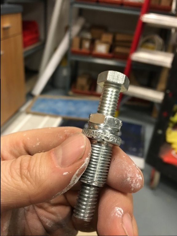

Now that it is together you may want to smooth over the sharp thread edges on the stop bolt.
