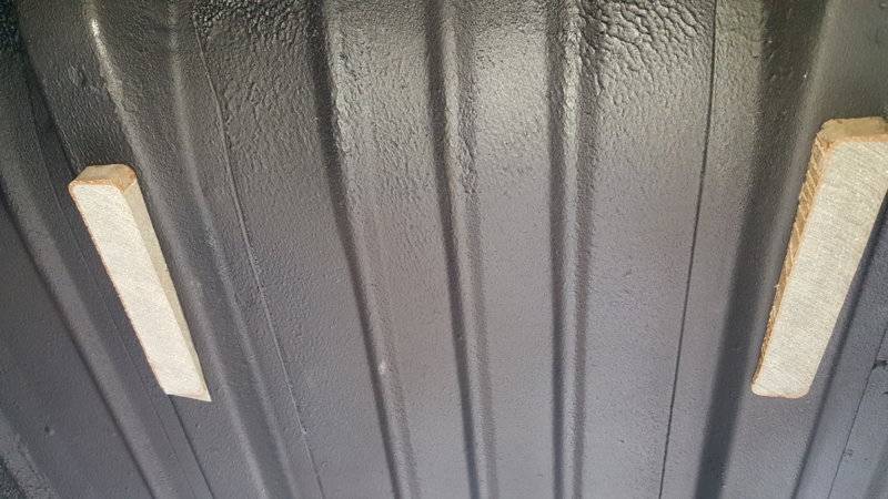

I did and it's not that complicated. Cut yourself a pair of wooden wedges (sorta like the way they mount a truck box on top the frame) that taper to lower just the front of the tank. If done correctly, the wooden strips will fit into the longitudinal grooves in the tank and should be held in with a few dabs of PL Premium. Place them in the outer most grooves of the tank. From the rear of the car you cannot see them and if you have J-bolts you can probably use the existing straps. Doing it this way gives you an airspace between the tank and trunk floor, prevents any movement of the tank and allows room for the upper hat of the fuel pump. I would recommend the pump go in the front right corner of the tan to ensure the pickup is always submerged in fuel. You cannot, under any circumstances beat the Aeromotive stealth.
I don’t suppose you have pictures of your install? When you say front right corner, is this the opposite position of the sending unit? I assume this set up still functions with the stock sending unit?

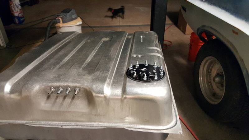

I put a areomotive phantom in my 71 RR. Only had to drop the front of the tank 1/4"

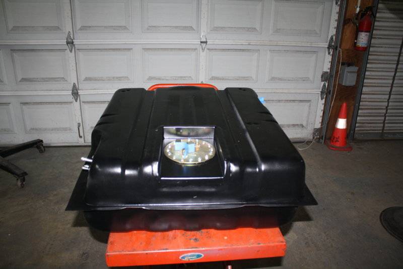

I put a Holley Terminator system in my 72 Road Runner GTX. Opted to get a fuel tank with the pump installed from Modern Muscle Xtreme (Martinsville, VA) based on a recommendation from a friend who builds Mopar muscle cars and has used MMX many times. Cost was about $700 for the whole shebang which was what I had saved on a promotion from Holley for the Terminator system.
Pleased with the product, and have had no problems whatsoever with it, well worth the t
Tank, with pump, bolted right in, with no body mods or shims.
