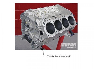

is there any way I can get you to give me a measurement from your china wall to your carb flange on your manifold?
You got me on that terminology... what is a china wall? I use the tall Indy single plane intake on my motor so not sure if the measurement would help??
The 440-1 heads are Max Wedge ports
Okay but yours are cnc'd, aren't the non cnc heads regular port. I'm not trying to argue just what I've thought I've read about them. Sweet looking heads by the way. I can't wait to get my victor max wedge heads back from getting cnc ported.
Here is your china wall.
I'm curious about your measurement because at the shop we found one that was .200 taller than the advertised measurement.

Thought that might have been what you were referring to, China Wall eh.. :) I'll see if I can find a way to get the measurement today. I'll need a way to project a straight edge from what ever part of the top flange may be exposed. You might be able to get this measurement from Indy more accurately?
