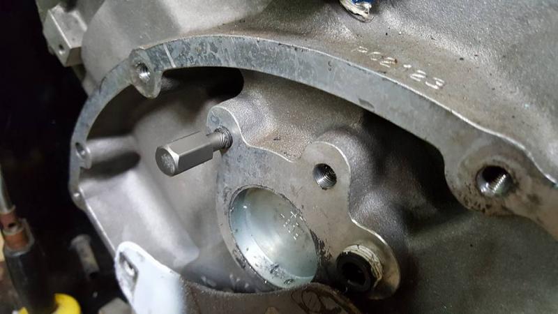

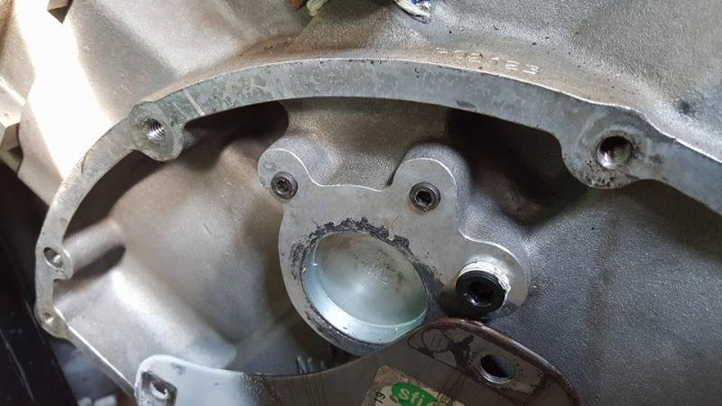

In the back of the block, I was finally able to remove the 2 -NPT 1/8" pipe plugs out of the back of the indy maxx block.
I'm trying to locate these restrictors to see what's back there.
I put a flashlight in there and don't see any restrictors.
My question is how deep are these restrictors in and would I see them right away?
1st time dealing with these Indy blocks.
There aren't any in there. That's why you're having issues. With those 1/8 npt plugs, you're probably going to have to make your own. How far in is the intersection of the lifter feed galley to the primary supply galley? Make sure your restrictors go past that.
I put a allen wrench which was about 3" all the way in and it bottomed out. I did feel something at that point.
What size restrictor do you think would help? .040
.060 is pretty common, .040 might be a bit too restrictive if you're pushrod oiling. Can you see what's in there 3" in?
From what I was told today. There isn't anything drilled or tapped in there from Indy. This is a total clusterphuck! I need bushed lifter bores, opened up valley oil drain backs and now restrictors put in.
Chris, are you push rod oiling? If so the standard Indy Max block has no provision for oil feed to the lifter.
Doug

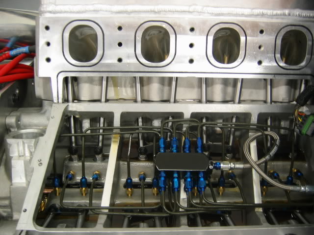

Doug
Yes I'm pushrod oiling and the indy block was drilled for hydraulic oiling right from indy.
My only mistake was NOT getting the lifter bore bushed from them before it was shipped.
I told Vignogna to bush it when he had received the block. He never did it. I pulled the valley inspection cover and he never opened up the drain back holes.
What's the plan now? Open up the drain backs, install restrictors and go? Or bush it and forego the restrictors?
Not sure till I get it all disassembled. I'm going to put a drill on the oil pump tonight and see actually how much oil the valley is holding and see where the problem is.
Mines mega block is bushed. It also push rod oils. It also had low oil pressure when first built. The fix was restricting the oil holes in the push rods themselves. They were .095. I sleeved them down to .040" each. Also Comp 829 lifters have huge oil feed holes to the pushrods if you are using them. Iskys are much smaller.
Doug
