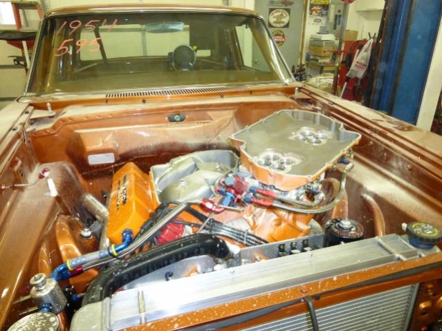

I run one. Are they as good as the best single dominator and Indy intake, no. If the car is heavy 3200 and up they ET very close. Mine has 750 Eddy crabs w/o the fillers. Car is very good. 9.20s anywhere. The only bad part is hard to start cold, throw a fender cover over the carbs. Don't pump to many times or Boom.

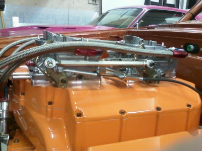

I have to disagree with Doug on this one. We did back to back to back dyno pulls with the Indy crossram vs. the 440-2 intake 440-3 intake and 4403X intake and we made 25 hp more with the Indy crossram.
I run Edelbrock 800's a Carter 750's on mine. Big CI don't need the plenum stuffers.
My 500 CI indy motor with the indy crossram does have the stuffers and I picked up .15 in ET.
My 588 goes [email protected] mph in a 3387lb. coronet.

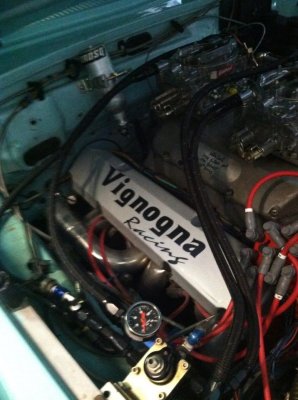

Some people say the single is quicker, some say slower. I know Andy F dynoed his and he said the single was worth more but i believe his motor was 512". There is a lot of plenum in the crossram. The larger motors suffer from small ports. The larger plenum crutches the small port. I think the larger the motor is the better the cross ram gets. Chris and I run 572 and larger. Both run pretty good. My 572 has been [email protected] @3345lbs. It's funny when people see the edelbrock carbs and their jaw drops.
