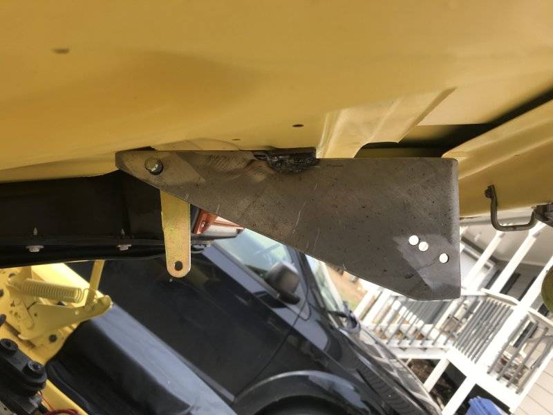

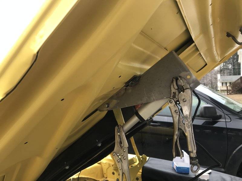

I made this bracket for a I think 2 inch stroke electric piston. If you need I can get the specs on the bracket I made. I went through about 4 different sizes before it ended up painted. I had to adjust the mounting holes a couple times. Fill the holes with weld and move them. But now it works great with a remote control. Also I can get you the info on the ram and remote setup.

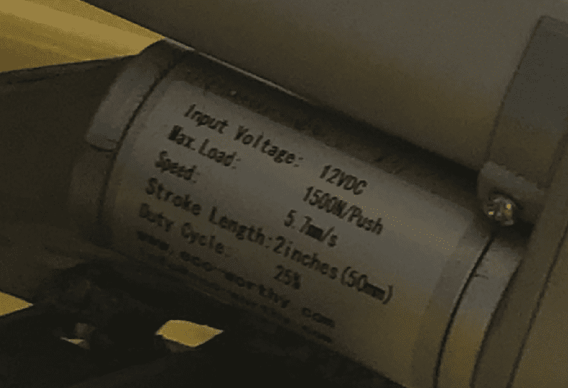

This is the motor..

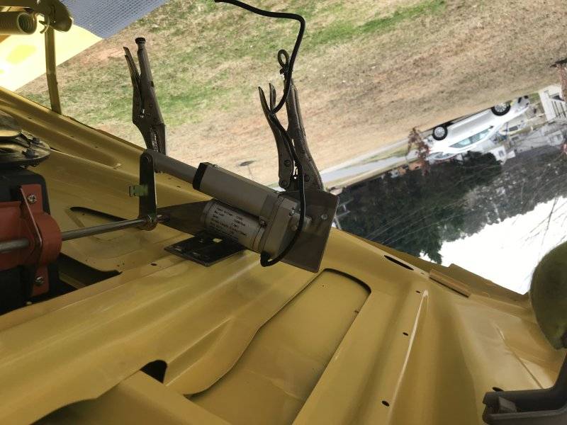

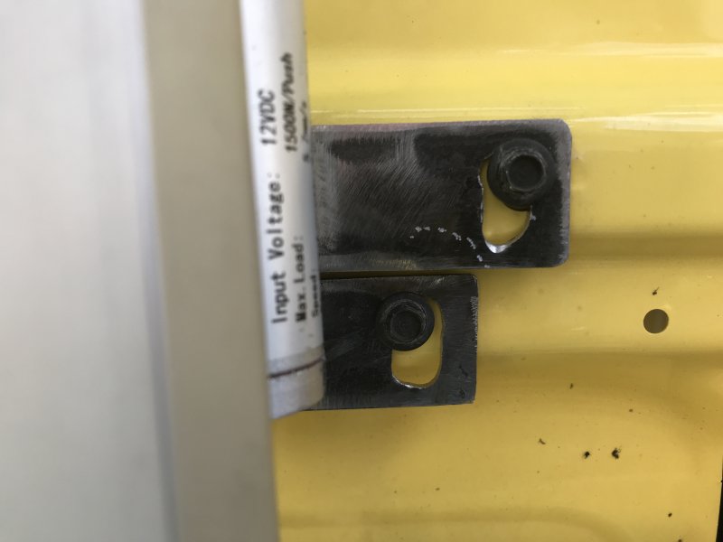

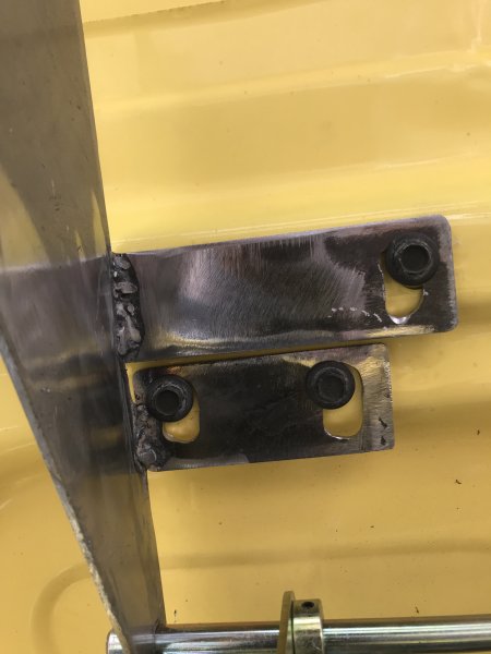

Here are a few more pictures from when I made the bracket. The arm is factory for the air grabber which typically hooks up to the vacuum actuator. So nothing needs to be modified on the air grabber door and pivoting method. All you need is a bracket like I made and make sure everything has its hole. The pin for the motor end of the actuator is one hole and the other is where the pivot shaft for the door connects to the piston side of the actuator. Here are a few more pictures. Keep in mind I made this with a cutoff wheel and a drill bit. Its not precision I had a few trial and error holes I made. I had to fill the holes with weld and grind them flat.
Thanks @BeepBeepRR I see how you did it. Since I don’t have any hardware I am going to have to fab up all the armature pieces that connect to the scoop/door. I have no shroud or linkages.
