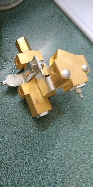

Can someone post a pic of the bad valve? I'm wondering if it's the same valve I got from Summit when I installed my SSBC kit. I don't remember what brand the valve was. Thanks guys.
I can take a pic tonight after work.....tues evening that is
Up date...sorry never posted the pic of the bad valve ill see if I can some time. but I got a new set from Dr Diff it looks to be the same stuff but if it goes bad I,m guessing they will stand behind it at least for a year. We will see how that goes. I called inline tube they gave me an email address to use to ask about my issue but I did not bother because I already know their answer. What I think they should do is put a disclaimer out stating they do not manufacture the part they just sell it and It may be junk......just saying. so the new part is installed, it only took about an hour to in stall but it took at least an hour and a half to get it to seal all the conections. I still have to do a test drive then check for leaks. good luck to me.
This is the bad valve in the foreground. It leaked out the bottom of the poppet...
