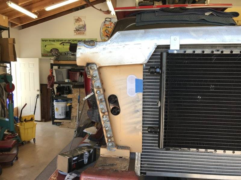

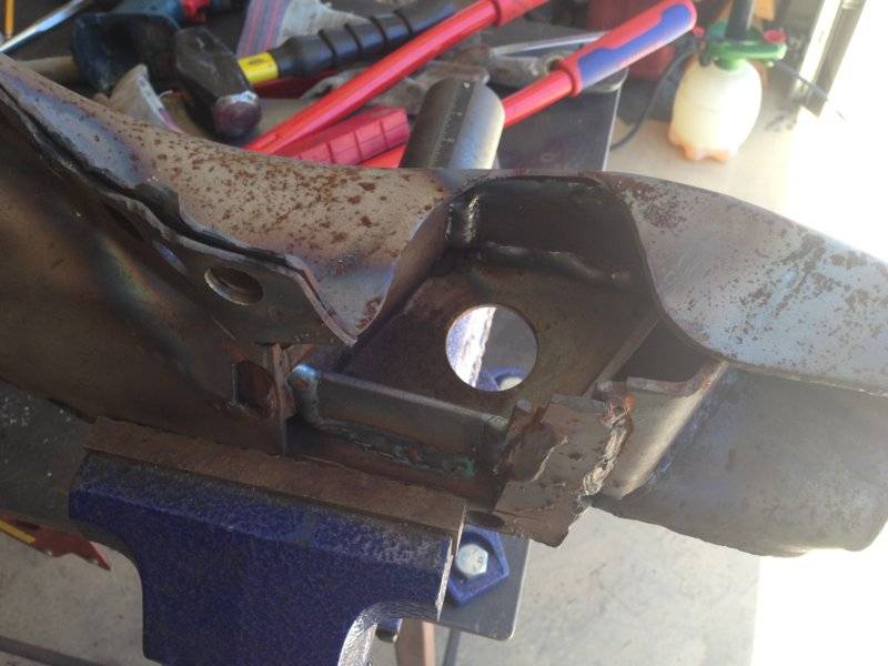

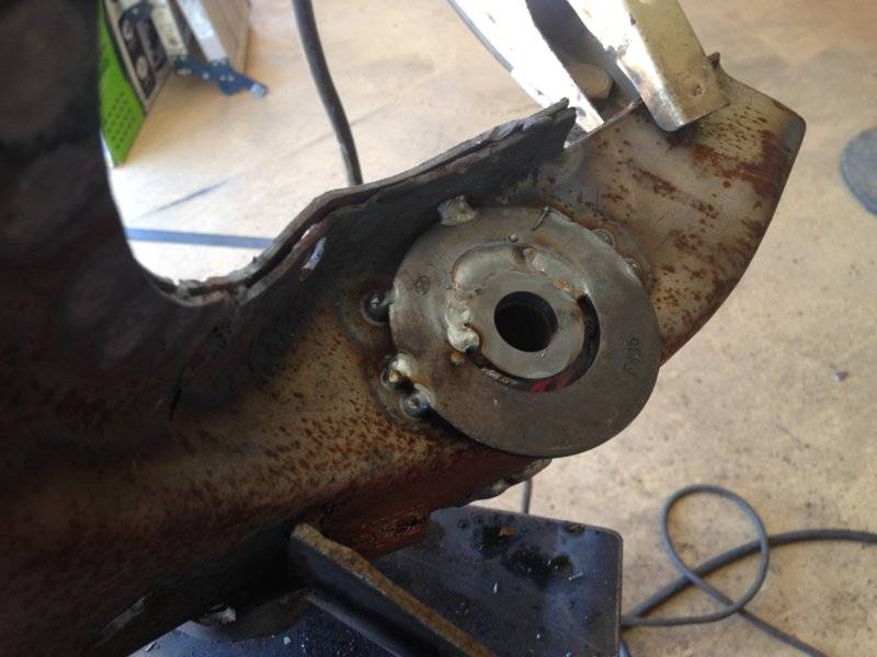

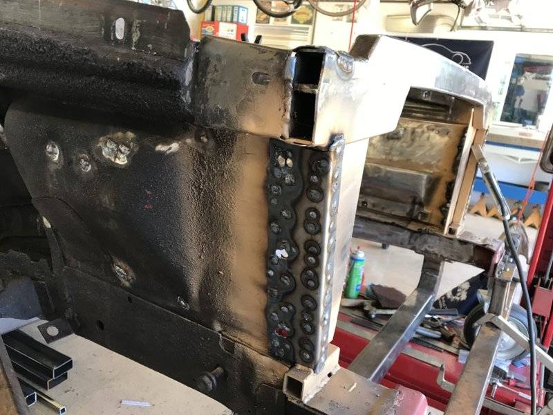

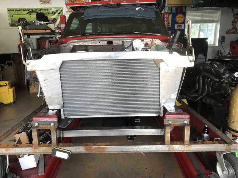

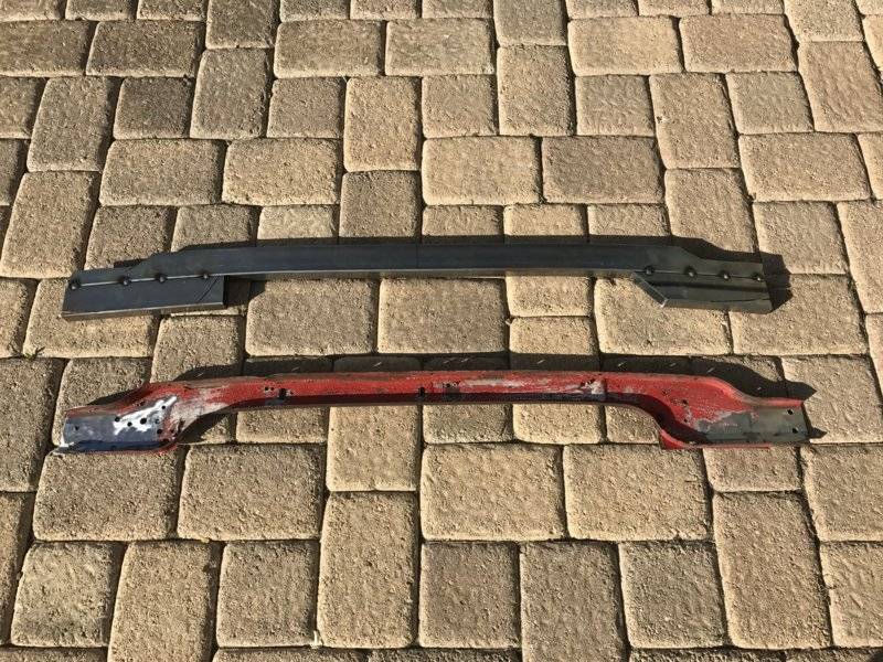

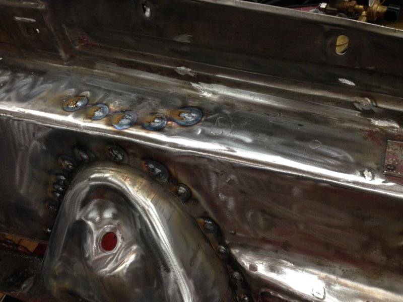

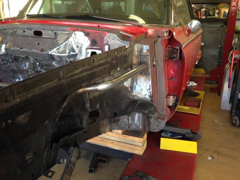

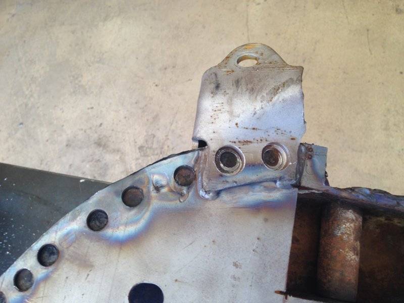

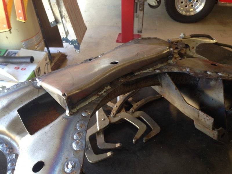

I made up my own core support, original was way cut up. Fender braces done with some bent tubing attached to plates on the firewall and also attached at outer shock tower/upper control arm area. Lower rad support made up with some square, 90's and plates welded to rails. Upper tie bar was done with some formed/cut/boxed cuts 1x2 90 wall rectangle, 1" square verticals, 20ga side baffles, 16ga corner wrap arounds with lots of rosette welds. I also added a bunch of rosette welds to the inner areas along the rails, inner fenders, shock supports.

Nice looking work!. Are you running stock style front suspension or after market?. Silly question but what size drill bit do you use on your 16 ga rosette welds? and how far do you space them ?.

Going to run oe based suspension. For the holes, I used about a 1/2" unit from one of my Blair Rotabroach sets. Look like mini hole saws. Went like 1" or so apart.
