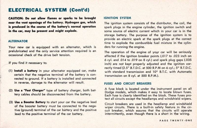

Also, I cannot find a fuse box anywhere, looked all under the dash, sides, engine.....does this car even have a fuse box?
Under the instrument panel...
