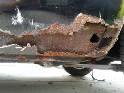

Can anyone help me identify this area behind the front quarters? I'm looking to replace them on both sides, here is a photo. Thanks. 20140731_184031.jpg
That would be the outer rocker and part of the outer wheel well from what I can see.
The Outer Rocker Panel tapers back a bit to allow the Quarter Panel to lay over it and fasten to the bottom of the Outer Rocker Panel, and Wheelhouse section. This entire area is trash, there is nothing salvageable there, at least in this pic, and the surrounding areas. I see these all the time torn down and you'll need to get down to the Rockers, it won't be pretty inside there.
I agree but I'm currently having some trouble finding a doner car if anyone can point me in the right direction it would be great. Thanks.
try moparmarks send him a pm :headbang:
AMD has patch panels I think.
