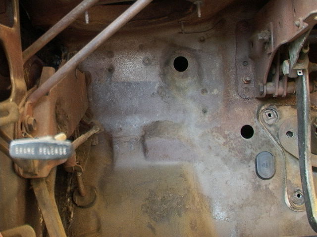

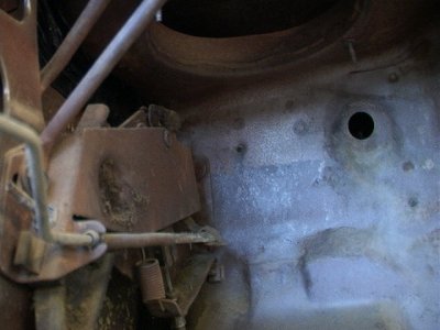

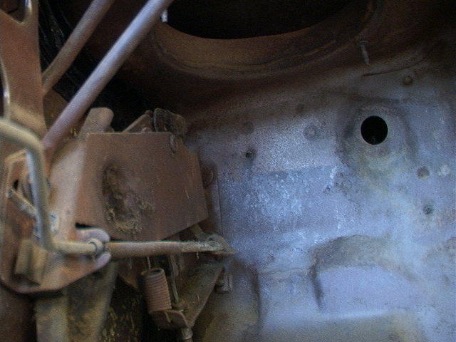

Purchased a used hood latch with cable and release handle for my 1972 Satellite Sebring Plus project. Do I need to make a hole in the firewall to pass the cable through? T found two large holes already in the vicinity, but one is way over behind the brake pedal and the other is kinda behind the fresh air vent box. And how/where does the release handle attach? Thank you.

bottom of underside of dash above ebrake, you use the big hole by the air cleaner(im not home but ill double check when im done work)

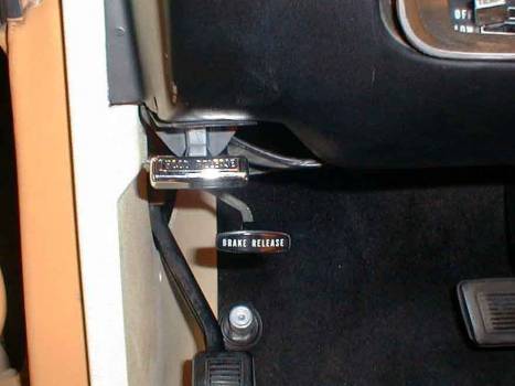

I have both. you can use both if you attach inside hood pull to existing release. inside & outside releases are slightly different.

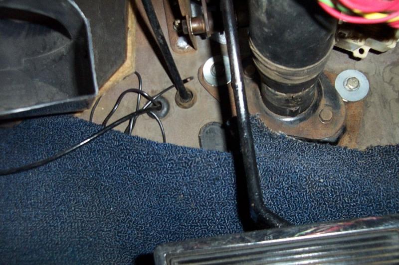

Actually your right. That lower right hole is for the speedo cable. Hood cable goes through a hole next to the speedo cable. Here is my 72 with inside hood release.

Well, it looks like it's time to get out my drill bits. I was hoping, of course, we would find a predrilled hole, or at least a dimple.
moparmarks pic is spot on with my 73 charger. I combined my SE car with outside hood release from rallye car. I used the outside hood release and attached the cable from inside release to it. both operate great. just like the thought of having both options and was simple to do. I find myself using both a lot. Just depends on if I am in or out of the car when I decide to open the hood.

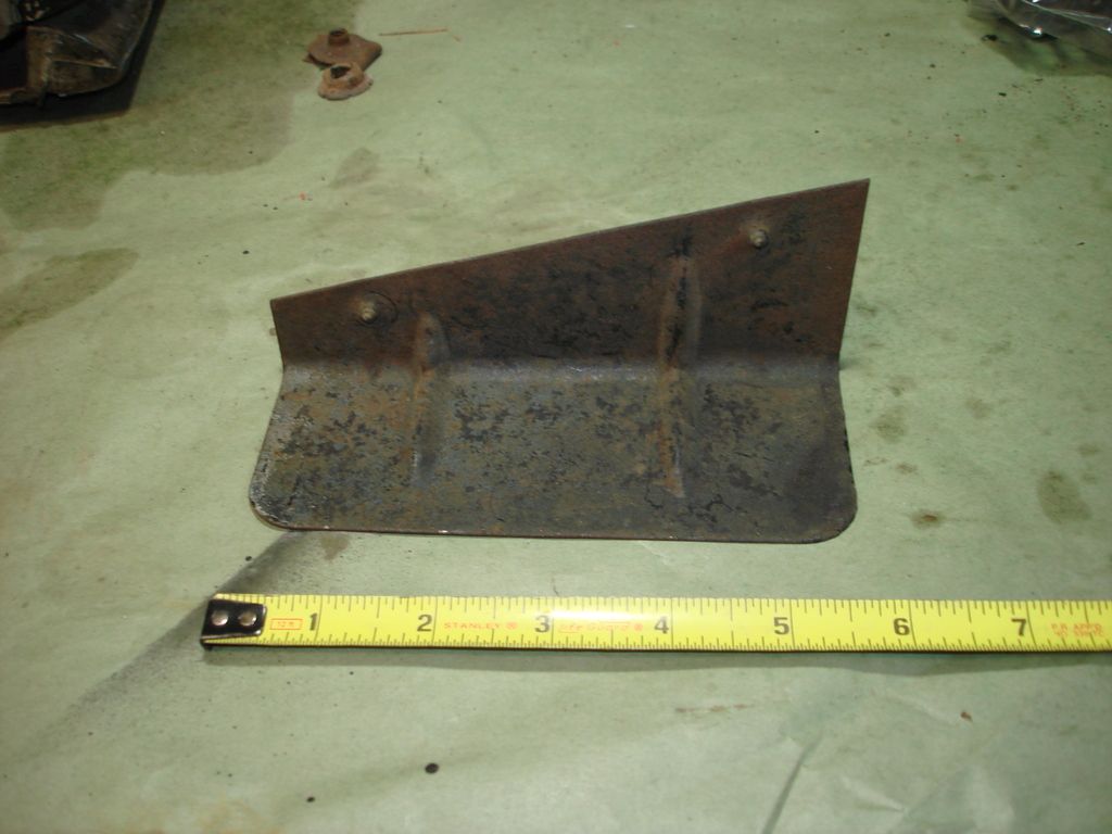

Matter of fact, the factory installation of the inside hood release includes a shield around the latch/cable mechanism to prevent access to the latch release from outside.
I am sotill looking for the inside hood release cable shield. (Picture of shield in post above) I guess i could fabricate one if someone could show me where it attaches and what it really looks like. I cant find it in factory service or factory chassis manuals. I'm getting ready to install the aftermarket cable snd a used latch. Thank you.
Mounts vertically to the center vertical support of the header panel, forward of the latch. Should see the mounting screw holes pre-stamped on the existing support.
