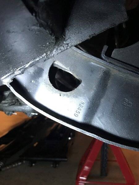

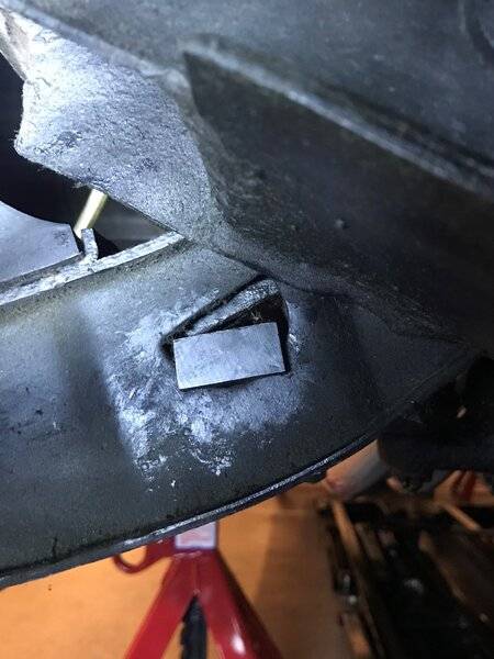

And here's some pics of the two front lower control arms. The driver side has plenty of room to get the torsion bar adjuster plate out, but the passenger side looks like there's more give and this adjuster plate won't come out (yet). Any ideas what would cause this misalignment?

GOOD, so your arm needs to be pulled fully down and your adjusting lever (that the adjuster bolts end pushes against) should be down about flush in the arm. This should have the socket approximately in position for the bar hex to slide right in. That said, it's damn hard to get one 60 degrees off, your adjusting levers end would have to be pointing at the ceiling.

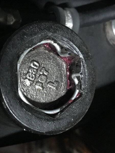

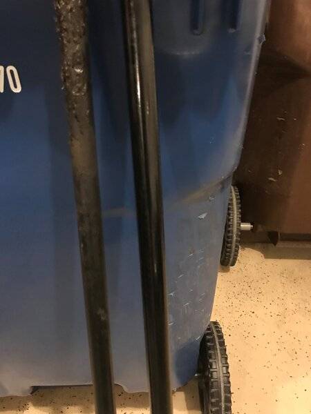

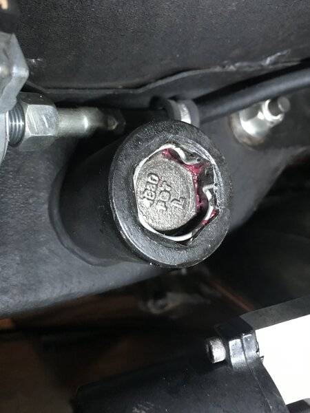

Torsions bars successfully installed, even though getting the poly dirt seals on were a royal f**king PIA. Pisses me off, no matter how careful you are, the bars still get scratched up going in through the back mount and then having to mostly hang out the back end while the fight ensues trying to get the dirt seals on the front of the bars; but she's not a trailer queen nor being judged, she's a driver. As mentioned in other posts, I also loosened the shock top nut so the control arms drooped more, and the bars slipped right in. This really isn't that hard, just follow what everyone else has said, and the install should be straight forward. And don't worry, the control arm won't come crashing down once the torsion bar is removed, it actually doesn't even move.
Car handles the corners way better now. A few simple pics.
