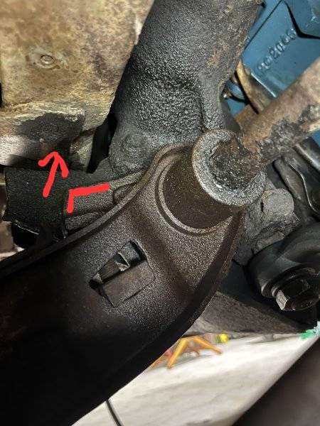

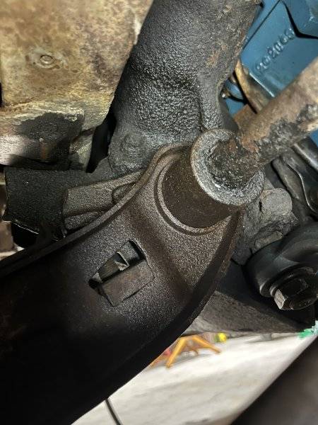

I took the below pic with the car on a jack but when the car has the weight on it the piece that the adjustment nut pushes on hits the groove above it. That can’t be good.
I think your torsion bar is going south. Many years ago I replaced the LCA’s because bent. I had SS springs on the rear(still do) and no problem setting front height.

Correct and you’ll notice you don’t see the screw head at all below the control because it’s screwed in so much.

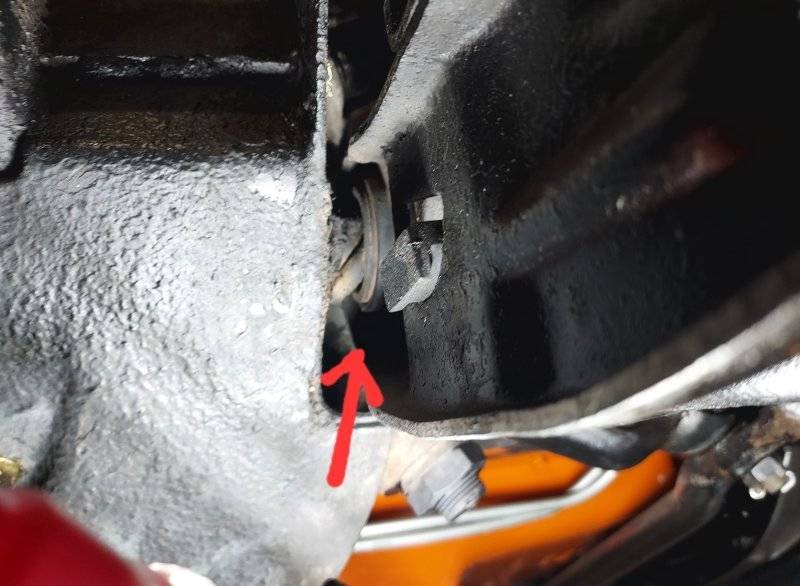

Take a good look and your lower control arm bushings. Worn out bushings can cause a lot of misalignment. See if they look like this one...
Also look at the condition of the cross member sockets.
LCA bushing was not in the list of parts replaced, agreed it needs to be inspected and replaced.
Also, sounds like the LCA torsion bar socket is free wheelin' inside the LCA.
