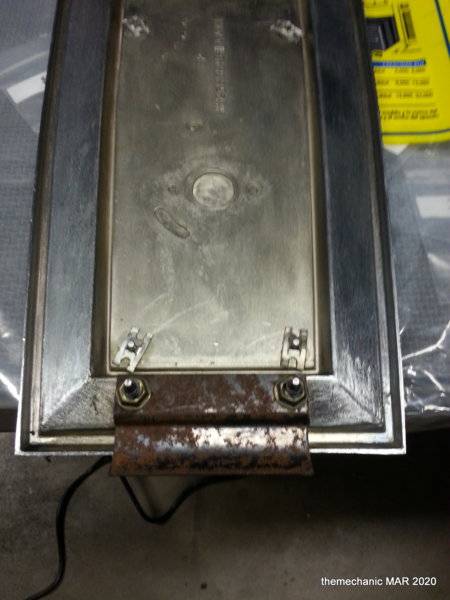

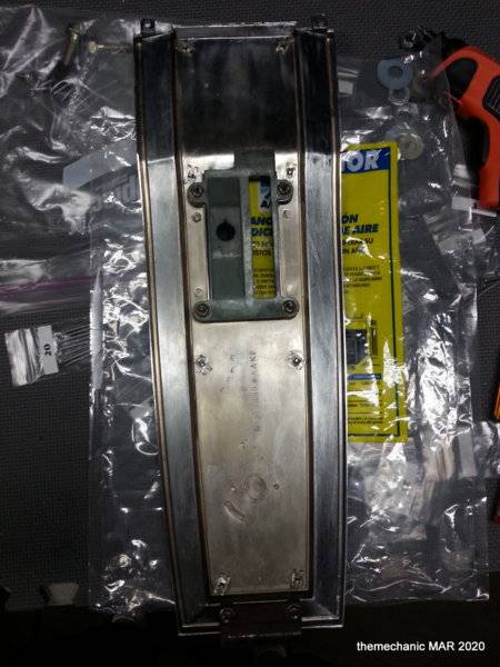

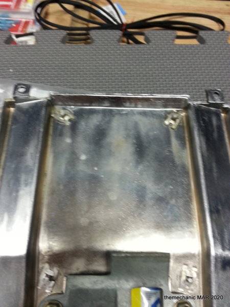

It should not move around. Factory consoles just use two screws and the shape of the console holds the front. Two tabs cast in hold it at the front.
Photos of my automatic console top plates showing the metal tab at the front that slides in under the plastic console body and the two screw holes at the rear for the screws that go into the plastic body. 4-speed consoles may be different, but I doubt it.
