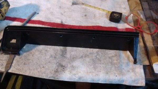

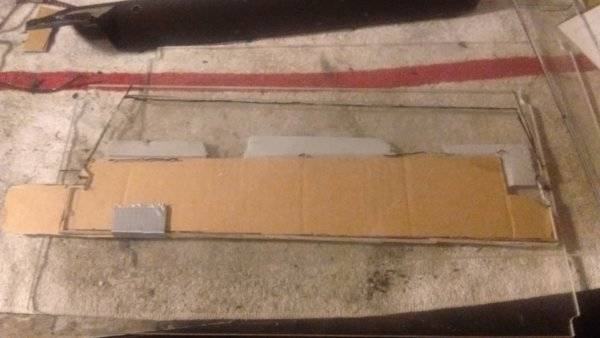

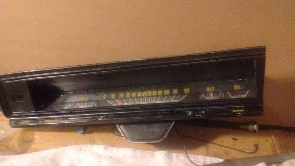

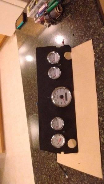

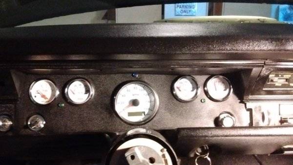

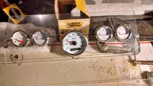

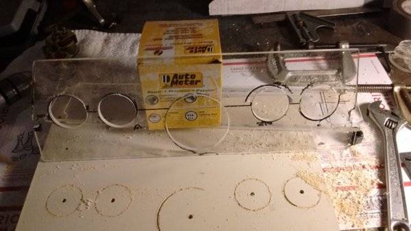

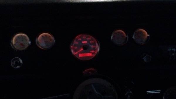

Been working on this awhile. Nothing worked in my dash , everything mounted under dash so I decided to clean it up a bit. I bought a GPS speedometer to replace the cable. I used part of an old cluster frame and 1/4" plexi glass . Marked and rewired dash and added after market signals and high beam light .
68 Dart
