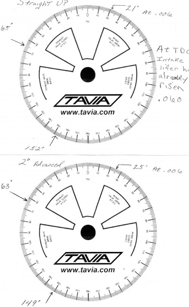

I am finally to the point of putting together my motor. I am double checking everything on the cam card. One of the first things I checked was the intake center line. I came up with 108 degr. but the card calls for 106 degr. If I advance the crank 2 degr I should end up at 106. Is this correct? Is this necessary? How does the 4 degr built into the cam affect this? It is currently installed dot to dot at tdc

Ok, I will take everyone's advice on leaving it but in checking other stuff on the card I noticed that at .006 I am at 24 degr. Is this do the intake centerline being at 108degr?

So I have it sitting at TDC. How do I do the math to figure out the duration if the intake lobe has already risen past .050. If I go counterclockwise so the lifter is on the heel, 0 the indicator then go clockwise I end up with.050 4 degrees after TDC.
65+152=217/2=108.5 for Intake center line
63+149=212/2=106 for Intake center line
Valve timing open at .006 I had to back it off(counter clockwise) to the heel of the cam.When the dial indicator read .006 while rotating clockwise, the 21degr and 25 degr is where it stopped. Is that the correct procedure?
Duration How can this be figured out if the intake lobe has already risen to .060 while sitting at TDC?
You ever stare at something long enough, reread something over and over and then realize the process you were doing wasn't correct to begin with. For the duration I wasn't taking the reading off the base even though I was told to. I was taking it off the lobe. Got it now!!! Thanks to everyone. I'm sure there will be more dumb ?? to follow.
