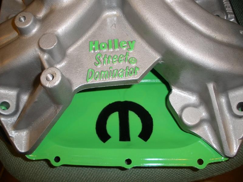

I'm getting ready to put my valley pan and intake back on and i have a couple questions. I was figuring i'd replace the intake bolts. Looking at summit i see a lot of different ones from $7 set to $50 a set. What's the difference? Could i just go to the hardware or autoparts store and buy some. Secondly does anyone know the torque specs for tightening it down. I would imagine being aluminum that the correct way would be in increments in a cross pattern. Is that correct? Thanks! P1251663.jpg

By the way great intake you got there!

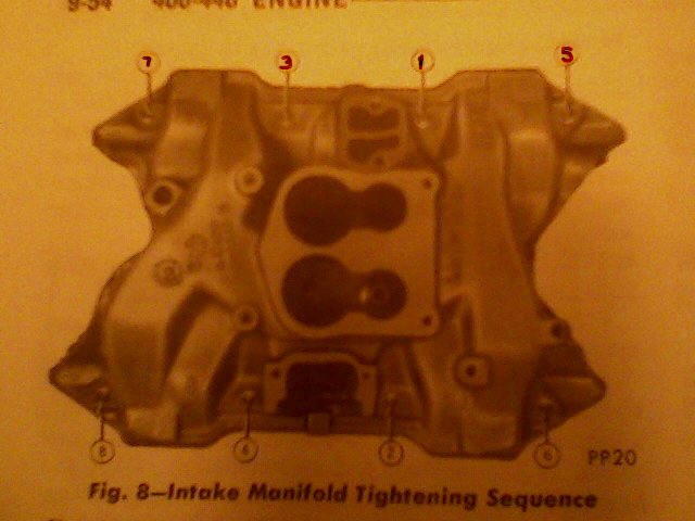

Thanks, anyone know the recommended tq, or where to find it?
diagonal and 45 Ft/lbs, watch for leaking at corners!

cast iron intakes are 45 , aluminum intakes are recommended at 35.
Thanks super77se, you are correct sir.
Mike

i see you finished up painting and putting the "M" on the valley pan...looks cool.

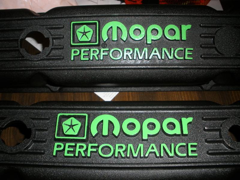

Thanks, Hoping that when i'm done with the green accents my engine compartment will have it's own personality. After painting the pan green and trying to stencil the M onto the uneven surface I ended up with too much overspray that didn't look good touched up. So i had to paint the black first, then go over it with the green. It didn't come out quite as nice as i would have liked, but it is what it is. I'm sure some people won't like it but if you don't, don't look at it. When i get it all back together with the green wires i'll post a finished pic. Looking for a used (on a serious budget) mopar performance air cleaner to paint to match the vc's. P1181650.jpg
