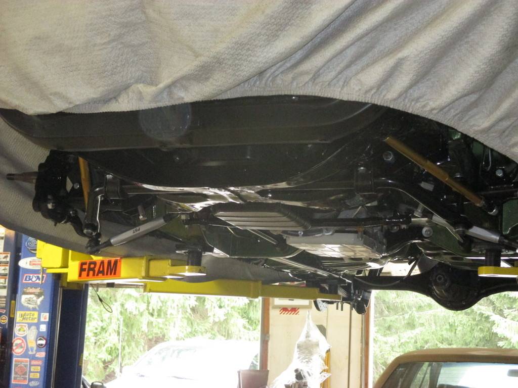

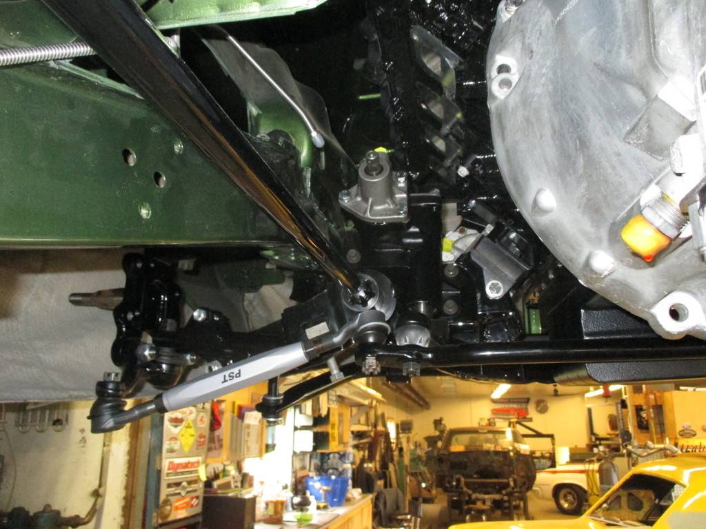

Have one for my `cuda ragtop. Just installed the rest of the front-end, yesterday. Borgeson box, QA1 lowers, Hotchkiss, uppers, 2" dropped spindles, c-body tie-rod stuff, 1 1/4" swaybar, QA1 strut rods, Bilstein shocks, and Wilwood 6-piston brakes.

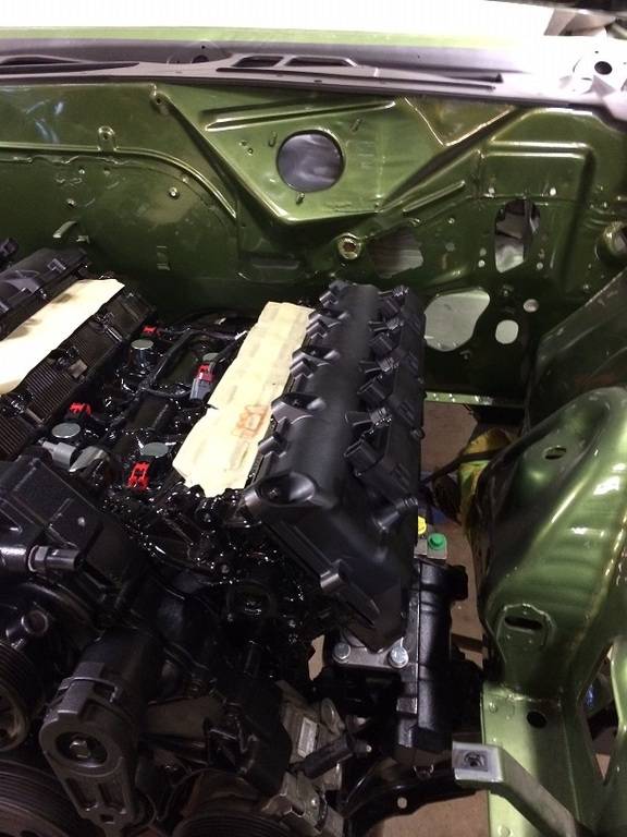

I'm sure someone else will be done before me. I'm doing the 6.4/NAG1 deal, and everything will be taking time to set up as I like stuff to be. It'll probably be about this time.....next year. Lots of dollars to gather and spend, and lots of stuff to engineer and fabricate.

After looking at the moparts thread, it would seem that the majority of people like to build lego cars, or they have a hissy-fit. It's no wonder my cars take a bunch longer to build than most people's. I like my stuff different, and we do lots of fitting and fabbing. I also believe most people are better off buying factory replacement stuff, if they aren't into a bit of drama and in a hurry. This car will have custom built headers and exhaust, as well.
The `cuda is also scheduled to have a hydro-boost system on the brakes, and the 40-50 year old factory stuff, ain't gonna cut it.
Firm Feel offers 3 stages of steering feel giving a bit more choice. But for clearance issues this smaller box will be a problem solver for sure.
I have the Borgeson box on order from Bergman Auto Craft, he is also supplying adapters, lines etc to my ididit column and 6.1 Hemi pump and reservoir. I chose this box for the extra clearance it gives me as well as the ratio.
