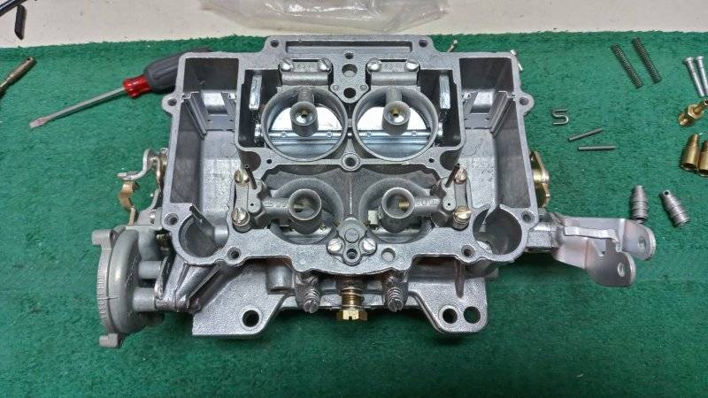

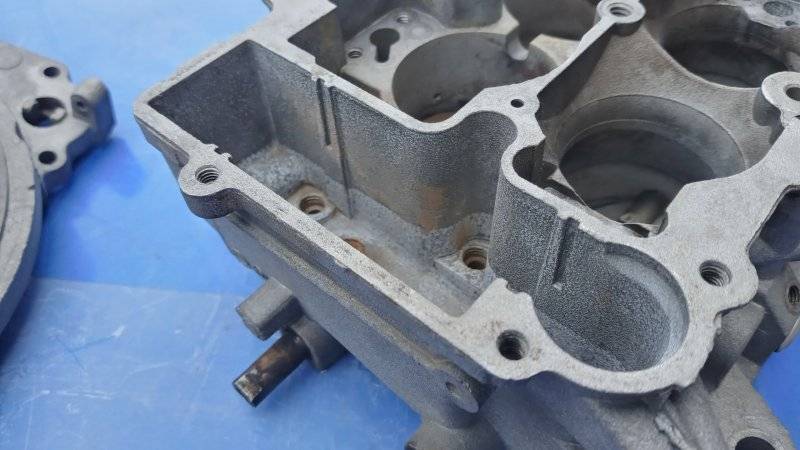

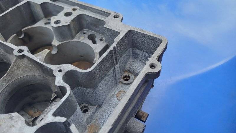

Picked up a Carter maxwedge carb that I disassembled for cleaning. Used ultrasonic cleaner with mild dishwasher and a little simple green. After it was dried out and sat, an interesting aluminum/Zinc leaching pattern developed.
First it does show how gasoline can attack the aluminum coating overtime; and allow it to leach out the zinc I presume.
Second it clearly showed the float level disparity between throttle side and choke side. Choke side is really low and would have been way lean on this carburetor.
Common problem with these carbs.

Was any of that etching pattern noticeable before the ultra-sonic cleaning?

Not as obvious. You can typically see residue, but don't associate it with long term level. This stands out like using a dye.

Was the carb body discoloured before cleaning? I have had lots of Carter alum carbs that have had a white residue on them. Wipe off with a damp rag, leave for a few days....& it comes back!
I also tried cleaning the carbs with various cleaners. The white stuff always comes back....
The float level disparity. Who knows? Maybe deliberately set that way for tuning purposes, not set properly, carb got bumped etc.

Not really just dirty. Moisture brings out the corrosion. I use a chrome mate conversion after cleaning and proper drying after media blasting. Just depends on whether it is a restoration or a rebuild. I have had carbs come out of the ultra sonic that look good enough for a street car. For a restoration oven drying after the conversion.
