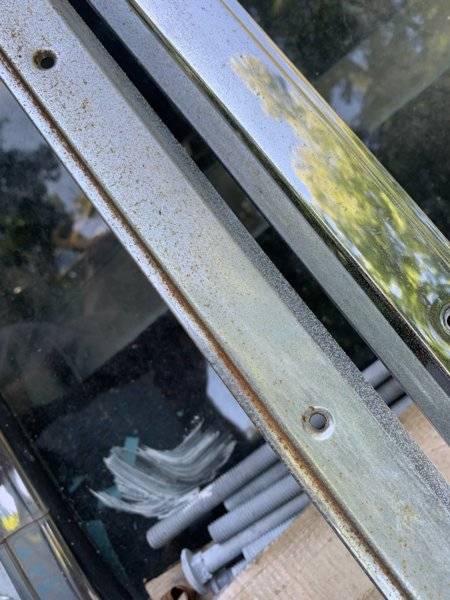

just found something that I want to pass along getting chrome back to looking good.
How did you do it? Brush?, rag? I think I'll try it.:thankyou:
4-0000 steel wool, squirt on metal start rubbing lightly, buff after. Did mothers and cleaned up a little better.
That piece was cruddy
Forgot to add, wiped off with cotton rag
