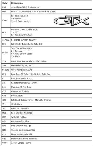

I am looking for some clarification on the color of the original seats in my new project. 1971 GTX, Rally red.
According to the sales brochure I found online and the Fender decoder the interior seats are labelled P6XW.
Decoder says P=Premium, 6=Vinyl Bucket Seats , X=Black

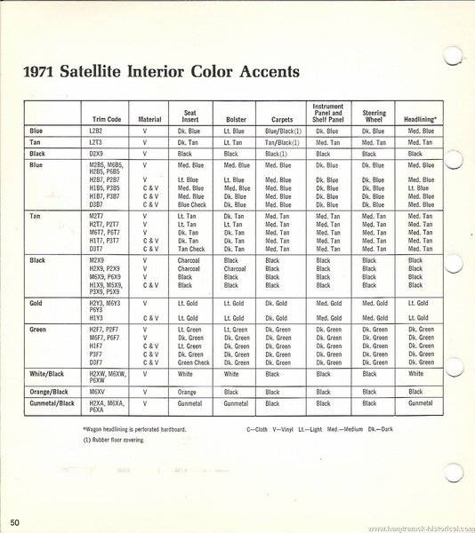

More Googling (second attached) says it may be a white seat color, white headliner, with black carpet and sail panels as seen attached? can anyone clarify ?
any and all info is appreciated!
The chart you posted is correct. Basically looks like this.
X (black) and W (white)

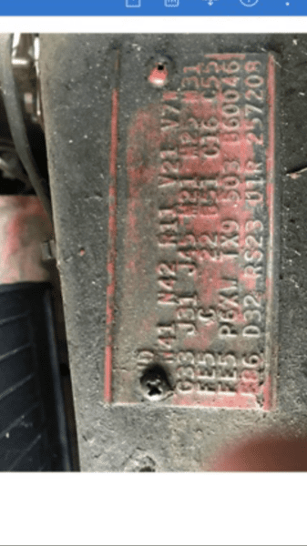

Thanks for the help ....of course that leaves me more confused. Here is my fender tag. The Tx9 after that means upper door frame is black /black velvet ( according to decoder attached )
so white door panels like the picture or black...
