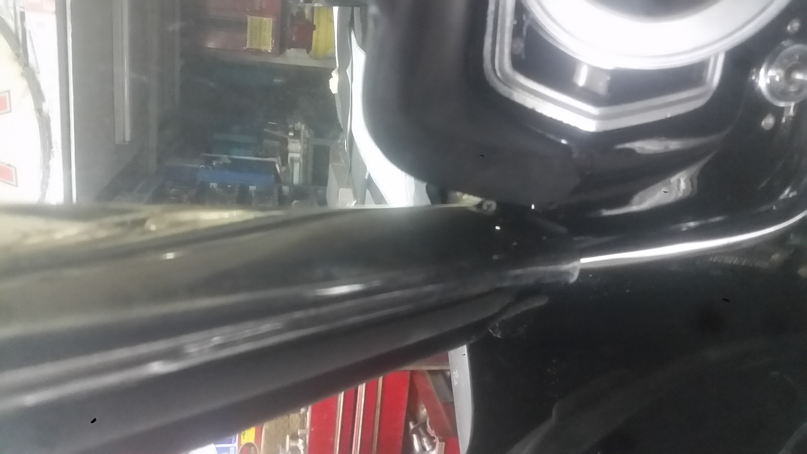

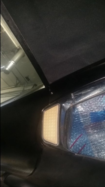

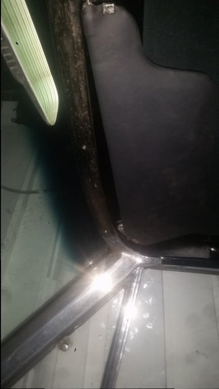

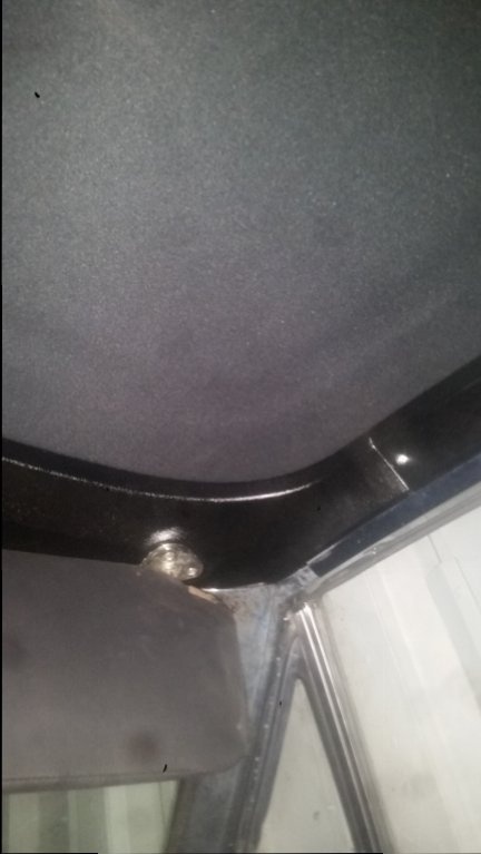

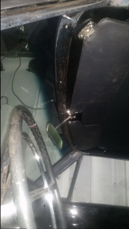

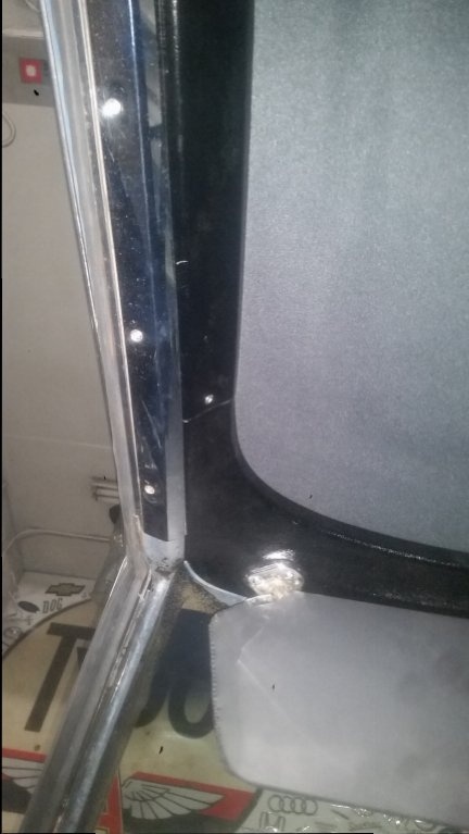

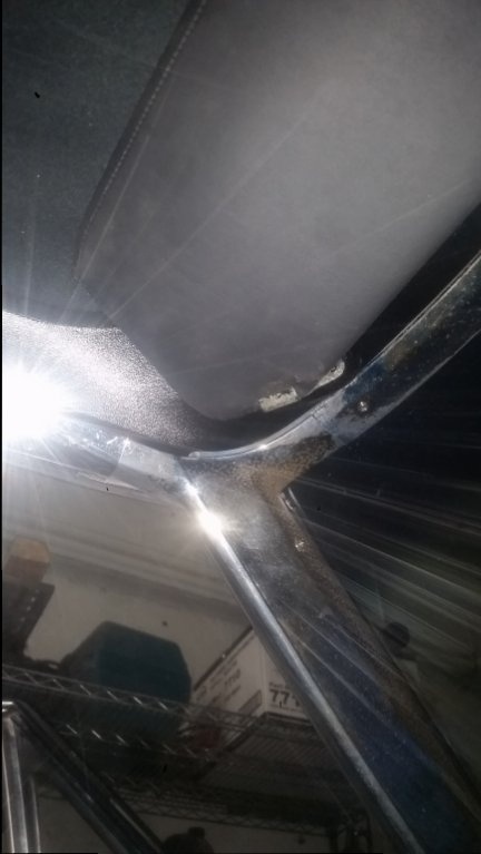

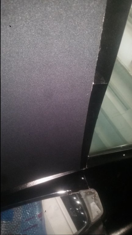

I would appreciate if someone could post pictures of the A pillar pieces from the dash frame to the roof and what goes up around the head liner from inside the car.
I'm having a bit of "fitment" trouble with the A pillar pieces and upper roof parts.
Where does it all go?
Like this
View attachment 1484692314846-1725329760.jpg 1484692341508-1708883178.jpg 1484692415012974258105.jpg 1484692449215805685124.jpg 1484692486409-136263557.jpg 1484692512625-1367149954.jpg 1484692548685-213266018.jpg 1484692569247-171426105.jpg

The bottom edge has to go in first and push down while you make sure it's around the post. Jam a piece of leather under it to protect the dash, then push foreward towards the windshiled to get the top inside screw

Well, the headliner was just a freshen up. I used SEM which can be bought lots of places. I used that on the plastic parts too. Same color.
Is that what you meant?
When I pulled it out, I found no insulation behind it. So that's the way I left it.
It's made of sometype of bonded fiberglass looking stuff. With a fabric on the face.

I bought headliner material off ebay and a can of 3m super trim adhesive and made my own it was relatively easy and relatively fast. It came out pretty good. see pics above
