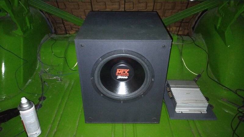

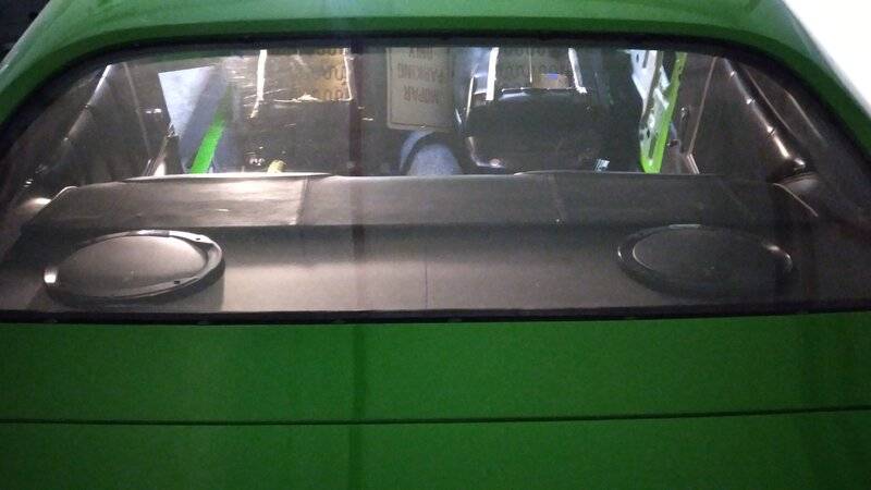

Gettin closer....made my own package tray and added some sound
^^^^ What he said.
I'm an audio system moron but why point the sub woofer to the rear?
Don't you want it pointed toward the cabin?
Teach me OB1.
A subwoofer pointing toward front or rear into to the trunk won't make a huge difference, even less with the bench and trunk divider panel. Low frequencies are in fact allmost omnidirectional, even more into an enclosure enviroment. Some phase cancellations will be on the run in fact, muting some frequencies depending on your hearing point.
Dunno if that cabing gets a bass reflex output on back?
Package tray turned out great... what materials did you use?
I made my own package tray too. I used what in Venezuelan is called “cartón Sholtz” which I think you can call “masonite”? Dunno. Is the same material used on door panels. Smooth on one side and textured on the other side. I think have a pic of that sheet somewhere. In Venezuela is sold on 8’x4’ sheets on same shops you can buy plywood

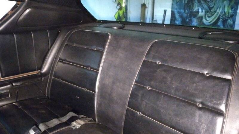

with same sheet also made the trunk divider panel backing the rear bench.
