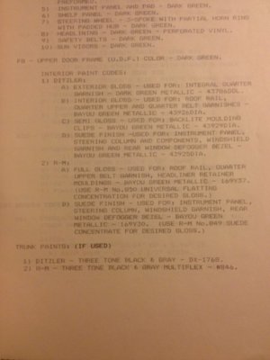

I am currently in the process of painting my 69 Roadrunner F8. The car also has F8 interior. I am using Chrysler paint code for the exterior 43786. Do I use the same paint code for the interior doors, headliner trim and rear quarter window trim? Steering column and dash are painted in f8 suede finish.
43926 is the only number I can find for the interior paint. Can anybody confirm this.
Interior paint will be the as the exterior with the exception of the dash and steering column as you already stated are suede. The trim along the headliner maybe suede also. Will have to check on that.
Maybe this will help.
That's perfect. I am confused about part A. It mentions exterior gloss used for integeral quarter garnish??
I guess I am painting the interior windshield trim, interior roof rail trim for headliner 43926
What code is used for the rear window metal quarter trim above the door panel? What about the front door interior color?
