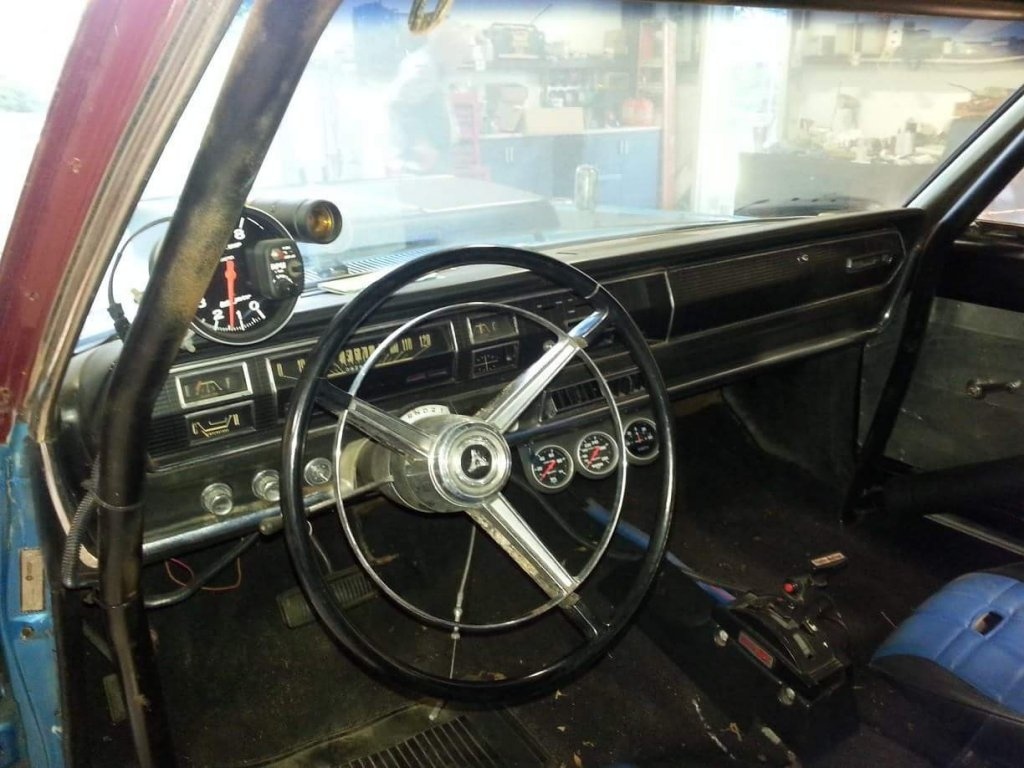

Interior pictures of 68-69 b body roll cage

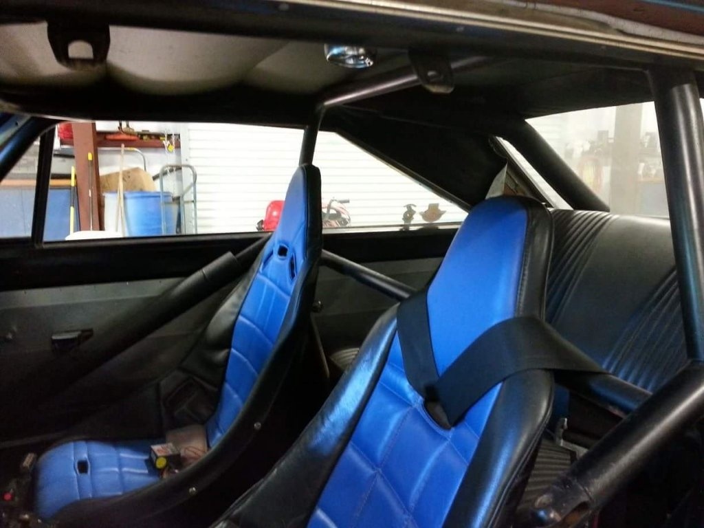

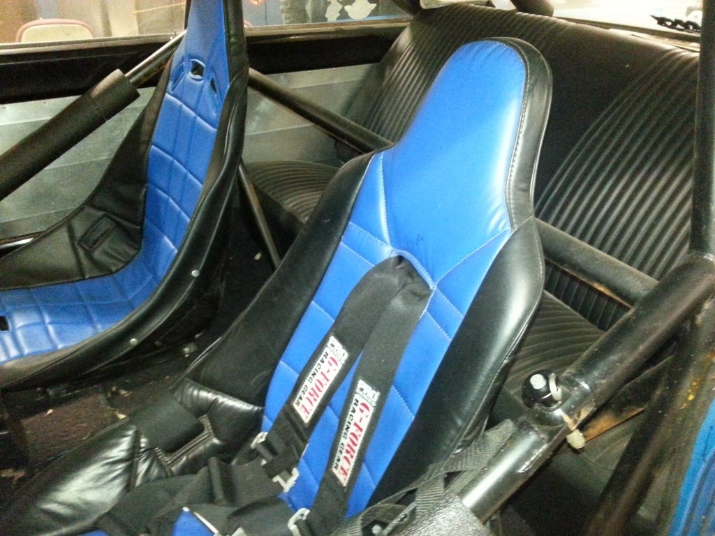

Mine is in a 67 , was last certified I think in 08 for 8.50... But since I'm not going to be running 10s I'm taking the door bars out and putting in the prostreet bars... Not going to attach at the floor , taking it to the A pillar down bar...has the drivers swing out

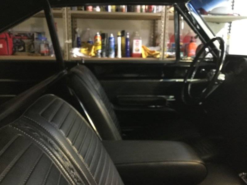

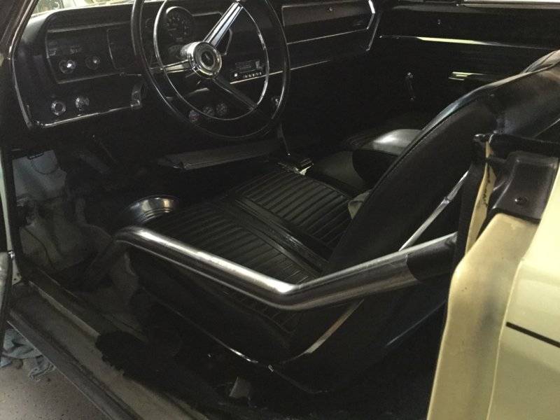

Mike, can you open the glove box?I have the alston cage and dont think I'll be able to so I'm reluctant to weld it in. Thanks

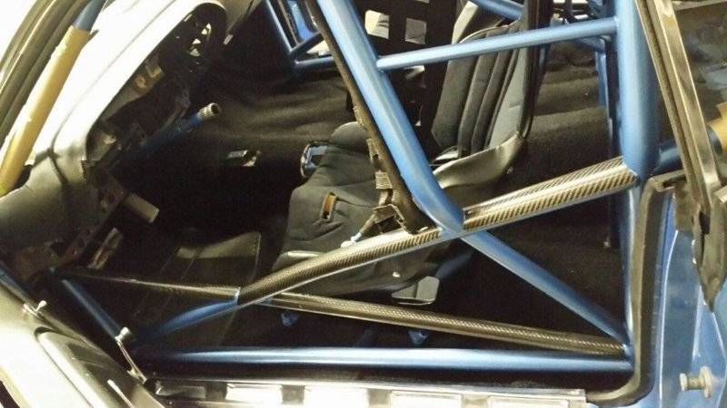

Cage looks good. I would add a kicker bar down from that first bend on the upper door bars. Similar to how mine kicks back on my car.

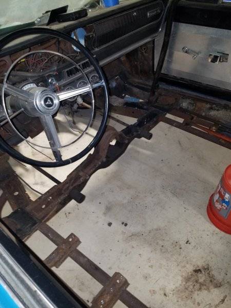

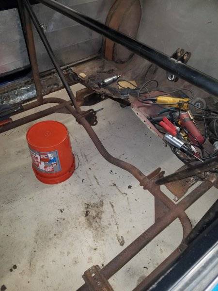

@440ronnie67 Here is a better pic of the pillar down tube, they are actually just outside of the dash and tie back into a subframe connector.
Ok thanks for the pic. I bet it was much easier to weld up while it had no floor pan. Thanks again
Well the cage was in it when I got it...had to do some snips here and there to get the pan in!!!
